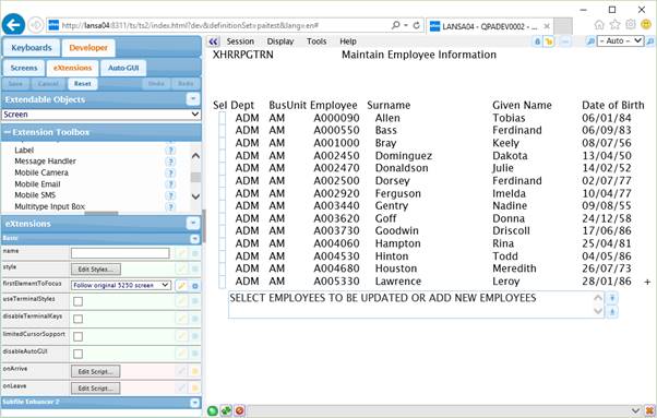

Step 3:
Lock the screen for edit.
Step 4:
Add an axMessageHandler eXtension. (drag and drop in a empty part of the screen)
Step 5:
Select the message text on line 22 and uncheck its “Visible” property option so that it no longer appears.
Save your changes.
The modified screen should look something like this:

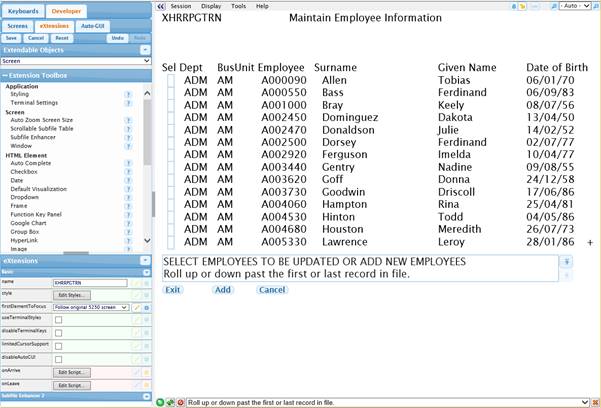

The display of the Up and Down button will change based on the theme set in Application->Styling->appStylesTheme property. When JQueryUI is selected, the Up and Down button will be displayed as a JQuery themeable button and the style will depend on the JQuery theme that is set in the Application->Styling->jqueryTheme property.
If addTerminalMsg is set to true, the modified screen will look like this.
