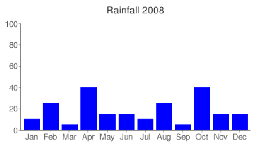

Here is some sample code to put into the onLoadChart property.
This code creates a table called Rainfall by month …
var t1 = TABLEMANAGER.getTable("Rainfall");
t1.insertChild ({chartData:"10",chartLabel:"Jan"});
t1.insertChild ({chartData:"25",chartLabel:"Feb"});
t1.insertChild ({chartData:"5",chartLabel:"Mar"});
t1.insertChild ({chartData:"40",chartLabel:"Apr"});
t1.insertChild ({chartData:"15",chartLabel:"May"});
t1.insertChild ({chartData:"15",chartLabel:"Jun"});
t1.insertChild ({chartData:"10",chartLabel:"Jul"});
t1.insertChild ({chartData:"25",chartLabel:"Aug"});
t1.insertChild ({chartData:"5",chartLabel:"Sep"});
t1.insertChild ({chartData:"40",chartLabel:"Oct"});
t1.insertChild ({chartData:"15",chartLabel:"Nov"});
t1.insertChild ({chartData:"15",chartLabel:"Dec"});
Together with these Chart properties …
produce this chart:
To produce a Pie chart with the same data set the Type property to p

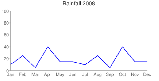

For a line chart set the Type property to lc

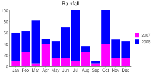

Using more than one data set.
To show more than one data set you must identify the row being inserted as belonging to a specific set. To do this use the optional dataSet property.
We can extend the above example by adding the Rainfall for the year 2007.
First we would have to add the dataSet to the existing 2008 data:
t1.insertChild ({dataSet:"A",chartData:"10",chartLabel:"Jan"});
t1.insertChild ({dataSet:"A",chartData:"25",chartLabel:"Feb"});
t1.insertChild ({dataSet:"A",chartData:"5",chartLabel:"Mar"});
t1.insertChild ({dataSet:"A",chartData:"40",chartLabel:"Apr"});
t1.insertChild ({dataSet:"A",chartData:"15",chartLabel:"May"});
t1.insertChild ({dataSet:"A",chartData:"15",chartLabel:"Jun"});
t1.insertChild ({dataSet:"A",chartData:"10",chartLabel:"Jul"});
t1.insertChild ({dataSet:"A",chartData:"25",chartLabel:"Aug"});
t1.insertChild ({dataSet:"A",chartData:"5",chartLabel:"Sep"});
t1.insertChild ({dataSet:"A",chartData:"40",chartLabel:"Oct"});
t1.insertChild ({dataSet:"A",chartData:"15",chartLabel:"Nov"});
t1.insertChild ({dataSet:"A",chartData:"15",chartLabel:"Dec"});
Next we add the second set using a different identifier than the "A" used above. Note also that we don't to specify chart labels:
t1.insertChild ({dataSet:"B",chartData:"50"});
t1.insertChild ({dataSet:"B",chartData:"38"});
t1.insertChild ({dataSet:"B",chartData:"77"});
t1.insertChild ({dataSet:"B",chartData:"9"});
t1.insertChild ({dataSet:"B",chartData:"30"});
t1.insertChild ({dataSet:"B",chartData:"55"});
t1.insertChild ({dataSet:"B",chartData:"90"});
t1.insertChild ({dataSet:"B",chartData:"11"});
t1.insertChild ({dataSet:"B",chartData:"5"});
t1.insertChild ({dataSet:"B",chartData:"66"});
t1.insertChild ({dataSet:"B",chartData:"33"});
Using the legends property we can add a legend for the 2007 and 2008 sets, change the title and add a color to the colors property for the second set like this:
Result for the Bar Chart (type bvs):
Result for the Line Chart (type lc):
