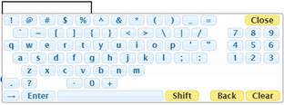

Setting the value “$.keypad.qwertyLayout” in the script mode will result in the following display:
$.keypad.qwertyLayout is a jQuery constant that indicates to the keypad to use the standard QWERTY layout when displaying the keypad. Other constants that can be use are the following:
$.keypad.numericLayout: Standard numeric layout
$.keypad.qwertyAlphabetic: Standard US keyboard alphabetic layout
$.keypad.qwertyLayout: Standard US keyboard layout
For special key markers, the following can be used:
$.keypad.CLOSEt: Close button
$.keypad.CLEAR: Clear button
$.keypad.BACK: Back button
$.keypad.SHIFT: Shift button
$.keypad.SPACE_BAR: Space bar button
$.keypad.ENTER: Enter button
$.keypad.SPACE: Empty space
$.keypad.HALF_SPACE: Empty half space
