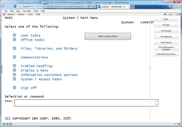

AutoGui options is accessible only on TS2 developer tools. Start TS2 developer tools within the development session or add “&dev” to URL of TS2 this will enable developer mode and AutoGui tab will be accessible within the developer tab panel. Check Show function keys on Panel to enable the options.
See screenshot below.
Function key panel
TS2 user mode
