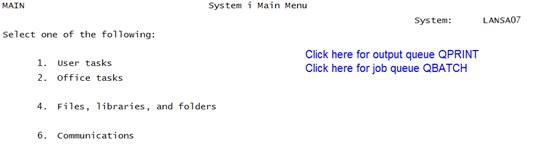

If the IBM i Main Menu screen has been identified, and the command entry field has been named "Command", then these axLabels are added to it:
Text
onClick
Click here for output queue QPRINT
FIELDS("Command").setValue("WRKOUTQ QPRINT");
SENDKEY("Enter");
Click here for job queue QBATCH
FIELDS("Command").setValue("WRKJOBQ QBATCH");
SENDKEY("Enter");
Then the command entry screen should look something like this …
When you click on the labels the commands WRKOUTQ QPRINT, or WRKJOB QBATCH are entered, and the enter key is sent.
In effect these labels act as command short cuts by allowing commonly used commands to be executed with a single click. This adds value to the application by making it easier to use.
