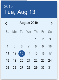

1 |
orientation: Portrait |
2 |

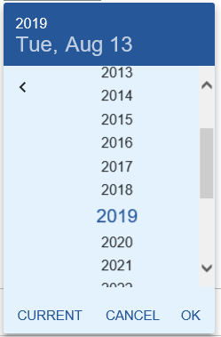

When year is clicked |

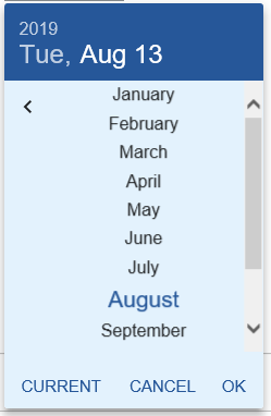

4 |
When month is clicked |

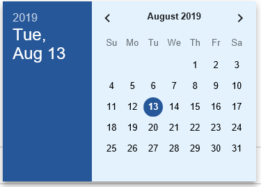

5 |
orientation: Landscape |
