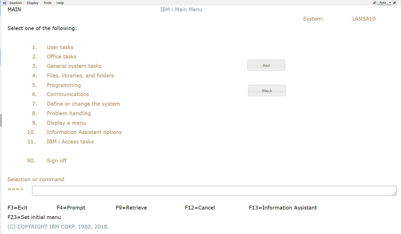

The starting point for this example is the IBM i Main Menu, where:
v  The 5250 screen is named MAINMENU
v  The selection or command field is named CommandLine.
v  Two push button eXtensions, captioned Red and Black, have been added.
The onClick property of the Red push button is set to this:
var oStyle = { "color":"yellow", "background-color":"red" };
var cmdfld= FIELDS("CommandLine");
cmdfld.setProperty("axdv.style",oStyle);
cmdfld.refresh();
The onClick property of the Black push button is set to this:
var oStyle = new Object();
oStyle["color"] = "white";
oStyle["background-color"] = "black";
cmdfld.refresh();
These button-click scripts first create a script object (named oStyle here) that specifies a text color and a background color.
Next they get a reference to the field CommandLine on the screen and alter its style (in fact the style of axdv - its default visualization).
Finally the command line field is then instructed to refresh its visualization.

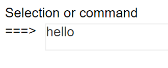

If you click the Red button the command line entry field should look like this:

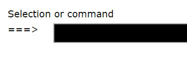

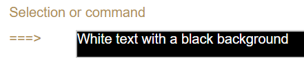

If you click the Black button the command line entry field should look like this:

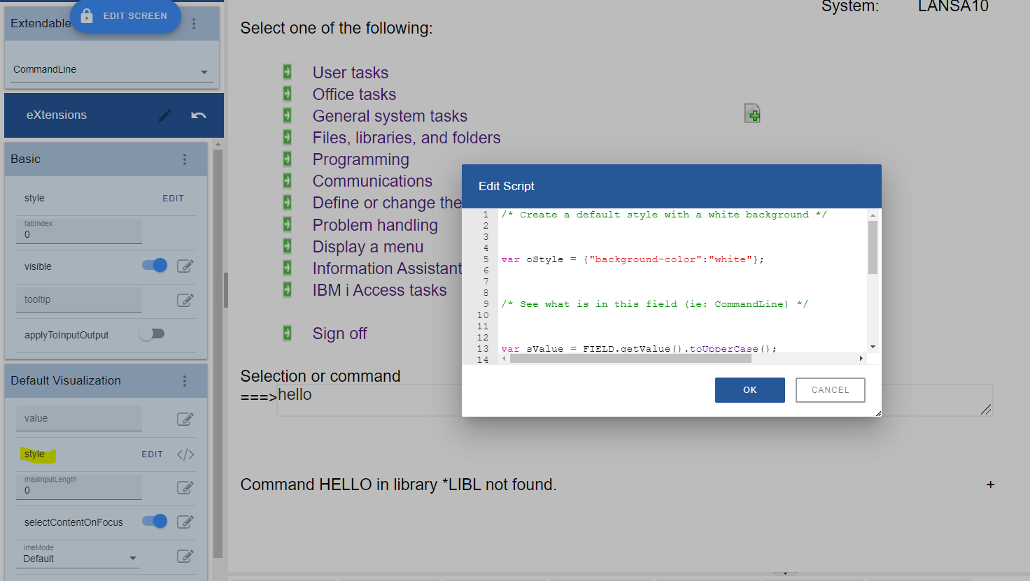

Self-styling can be demonstrated by altering the example started in the preceding Basic Concepts section as follows.
First, the CommandLine field is selected, and the Style property of its Default Visualization is changed to be evaluated by executing script:
Where the script used is like this:
/* Create a default style with a white background */
var oStyle = {"background-color":"white"};
/* See what is in this field (ie: CommandLine) */
var sValue = FIELD.getValue().toUpperCase();
/* If it contains blue or green make it the background color */
if ((sValue == "BLUE") || (sValue == "GREEN")) oStyle["background-color"] = sValue;
/* Return the style object to be used for this field (ie: CommandLine) */
ENV.returnValue = oStyle;

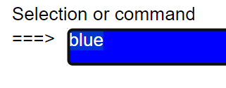

This change is saved and then the IBM i Main Menu is executed.

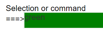

If you type the word green or blue into the command line and press enter (or any key that causes the screen to be redisplayed by the server), you should see the style change like this:
Or like this:
Type anything else into the command area and the default background color of white will be used:

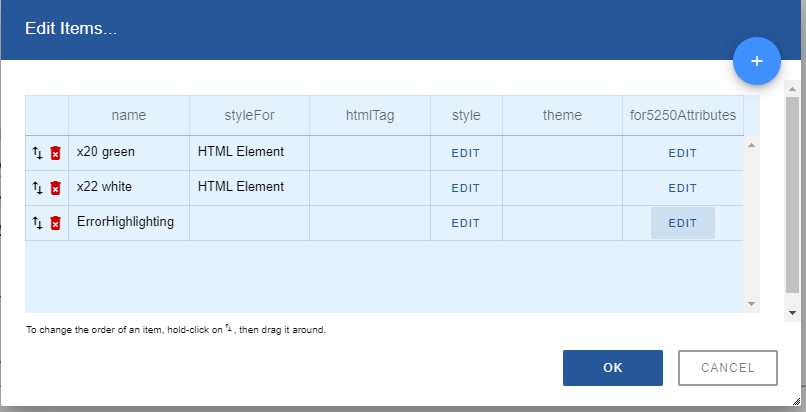

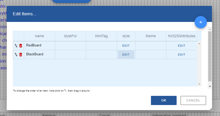

Setting Styles Dynamically – Using Application Styles/Themes
The preceding Basic Concepts example used hard-coded style elements for the color and background color.
A better solution may be to use application level styles.
This approach also allows the styles to be dynamically themed.
If the application level styles named RedBoard and BlackBoard are defined as:
Then the code for the Red button could be changed to this better code:
var oStyle = { _base : "RedBoard" };
cmdfld.refresh();
and for the black button:
cmdfld.setProperty("axdv.style", { _base : "BlackBoard" } );
cmdfld.refresh();
Here the special property _base in the style object is used to specify the application level style name.

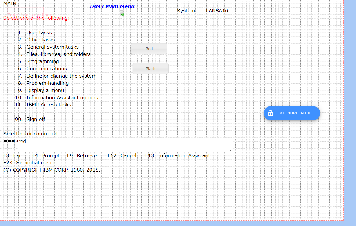

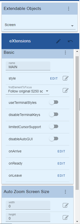

Understanding Screen Sizing and the Thin Red Line
aXes is designed to display 5250 screens, which are typically 24x80 or 27x132 lines of characters/columns. By default, aXes will display an area that represents this type of screen size (also see the next section about row/column size to understand how the default 5250 screen size is calculated).
When enhancing screens you can create more screen space - but before doing this it is best to understand how the screen sizing process works.
Display the IBM i Main Menu (named MAIN).
Set the aXes zoom factor to 100% using the drop-down in the right top corner of the screen.
Stretch the browser window out so that what you are seeing is much larger than the 5250 screen display area.
Put the screen in edit mode by clicking on Lock Screen icon.
Initially, the area inside the thin red line represents the "5250 size" of this screen.
In TS2, you can no longer position the elements beyond the thin red line.
However, you can make more space on enhanced 5250 screens.
Select the Auto Zoom Screen Size extension from Extension Toolbox then drag and drop it onto the screen panel.
Then the screen customization window will now look like this:
The width and height properties of the Auto Zoom Screen Size extension allow you to specify the logical dimensions of this enhanced screen. In effect these properties allow you to move the thin red line boundary.
Specify width and height properties, something like this:
Note: These values are logical sizes, in pixels. It does not mean you have to have a screen that wide or high to display the screen. The auto zoom feature will zoom your screen in or out to fit the available browser display space at any time, no matter how large or how small it is. Refer to Screen Size documentation for the description of other properties such as zoom and lock zoom.
You should be able to move the boundaries out, something like this:
Save your screen changes.
Navigate off this screen and back again to make sure the sizing information is reset, properly.
Now start changing the screen zoom setting again.
You should also try logging on to aXes as a user and checking your screen there when using various zoom sizes.
You should find that your "big" 5250 screen is correctly visible at all zoom sizes, particularly the Auto and Fit sizes.

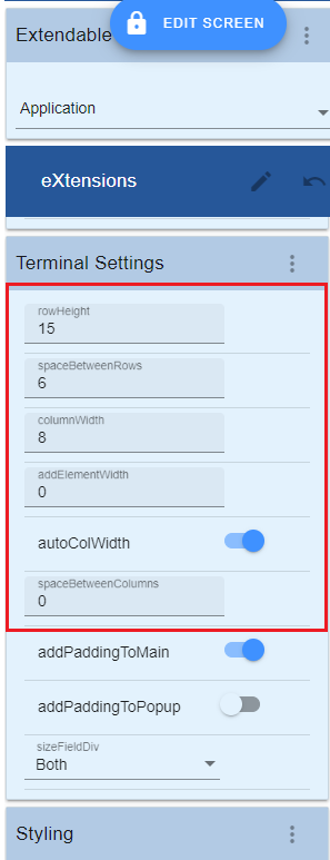

Changing 5250 Row / Column Size
By default rows in AXES 5250 screens will be 15 pixel high and columns will be 8 pixel wide.
If for some reason you decided to use a larger font and changed the global style font to Verdana, 12pt, your screen will look similar to the one below:
Reminder: you need to set the useTerminalStyles property of this screen to false to allow custom styles to take effect.
You can see in the screenshot above that the edit boxes adjust according to the specified font size.

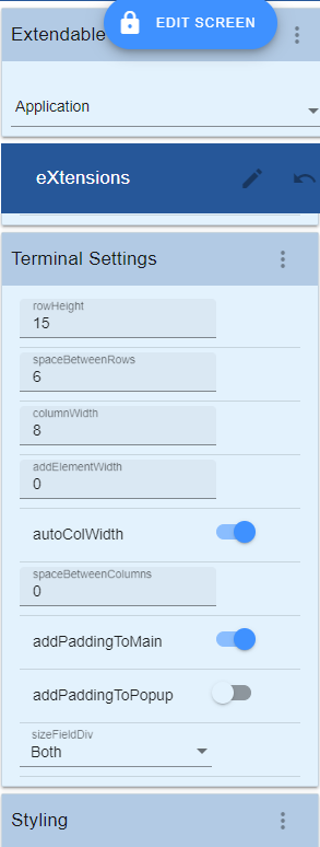

Use an application-level eXtension Terminal Settings to allow you to easily change the default height of rows in 5250 screens.
Follow these steps to use this eXtension:

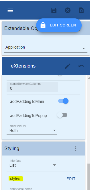

·         Go to the aXes Developer window.
·         Lock the screen to switch to edit mode.
·         Select Application from the Extendable Objects dropdown to view the Application Properties.
·         Even if you have never customized a screen before, the Application Terminal Settings eXtension is already included in the Application Properties.
The value of the Terminal Settings properties in the property sheet is default.
<< TODO Update this part!>>
Set the rowHeight to 25 and spaceBetweenRows to 5. Save the settings (click the Save button at the top of the window). You will see your screen changes immediately to the one below:

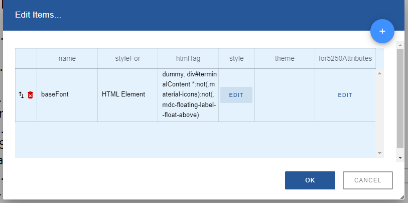

About Fonts and Font Sizes
We recommend that you do not change fonts or font sizes via shipped style sheets or use customized style sheets to change fonts or font sizes.
If you change a style sheet you may need to clear your browser cache to get the changes.
We also recommend that you do not use variable width fonts on un-customized screens because somewhere down the track you will encounter a problem on a screen with subfile content or headings that appear to become misaligned.

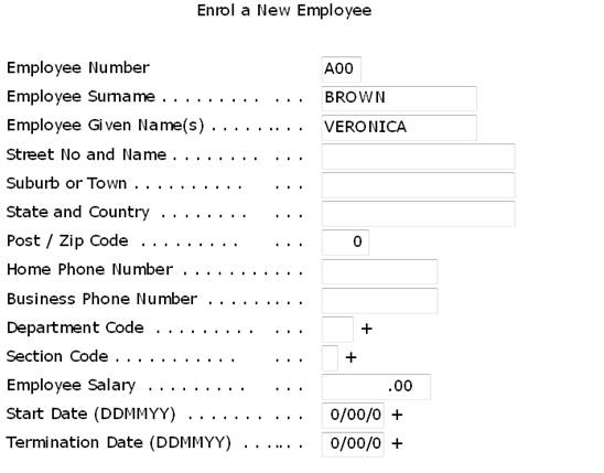

—  If an RPG program puts out these subfile headings as a single text output field:
   Customer Product     Order    Quantity    Value
   18181818 6373737     8484848       700    1,234.56
You may end up with a display like this, when using a variable width font:

—  To change fonts or font sizes use the application definition eXtension. See Tutorial 7 – Themes. Changes you make to fonts and font sizes here may be applied to customized and non-customized screens.
—  A 5250 screen is inherently a fixed width device which uses fixed width characters. A 5250 screen has 24 x 80 or 27 x 132 fixed width and height cells that may contain a character. Starting to use variable width characters in this model is always problematic and needs to be treated with care. aXes uses specific dimensions that indicate how wide and high a 5250 screen "cell"  is when it has to perform screen layout calculations.
—  <<TODO Edit – waiting for confirmation>>If you use a large font, or a font that is wider, you may need to adjust these cell sizes. This is done here:
If you change these values you need to check several customized and un-customized 5250 screens to see what impact your changes have made and how they operate in conjunction with your font and font size.
—  These cell size changes impact customized and non-customized screens. You should set your font and font size early and adjust the screen cell sizes accordingly. Changes made to these values when a project is in progress can impact the layout of screens already customized.

1. Open the styles property of the application:
2. Create a style called ErrorHighlighting as shown:
Style: background-color: red

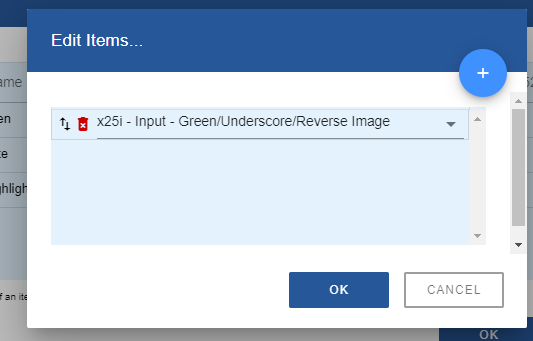

3. Click on the for5250Attributes property.
Add an item. Make it display attribute 25 - for an input field
(x25i - Input - Green/Underscore/Reverse Image)
This display attribute is commonly used by applications to indicate that a field is in error

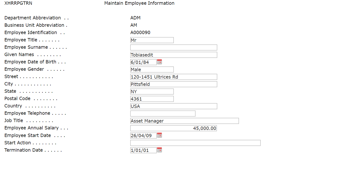

4. Exit the style properties and save Application properties. You are now ready to test your change.

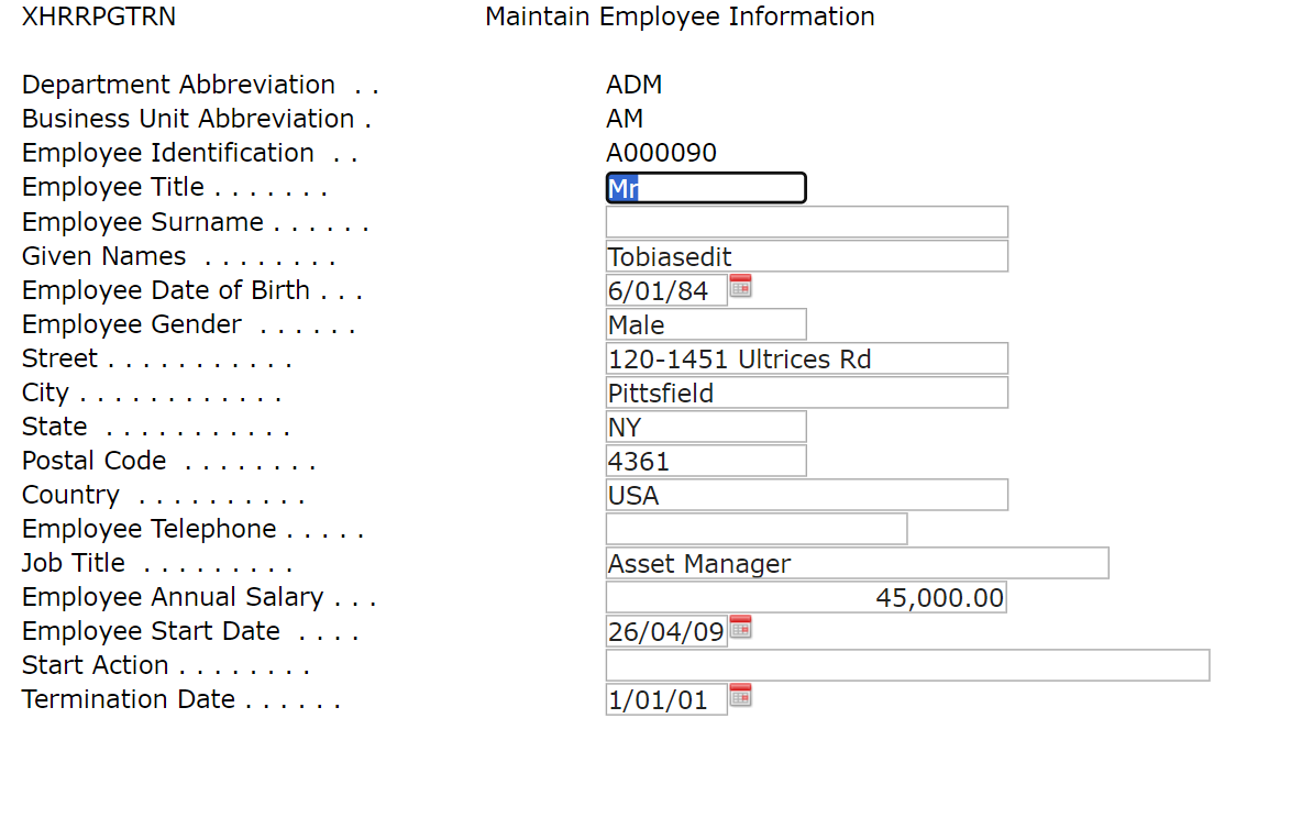

5. Run program “LIBRARY/LANSA RUN PSLSYS”.
Select Enroll a New Employee option. Blank out details and press enter, you should see the fields in error highlighted in red.
Now try editing the ErrorHighlighting style.
Change the background color to Yellow and save your changes.
Restart the 5250 application again.
The background color should have changed from Red to Yellow.
