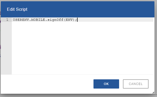

Using centralized signOn() and signOff()  logic
Your USERENV.MOBILE object contains functions signOn() and signOff().

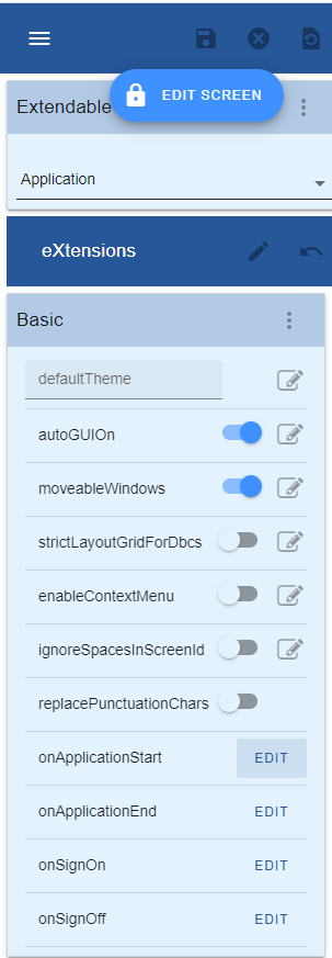

Plug them into your project by editing your application properties so that they are called at the appropriate times - like this:
The calls are
   USERENV.MOBILE.signOn(ENV);
   USERENV.MOBILE.signOff(ENV);
Save your project changes.

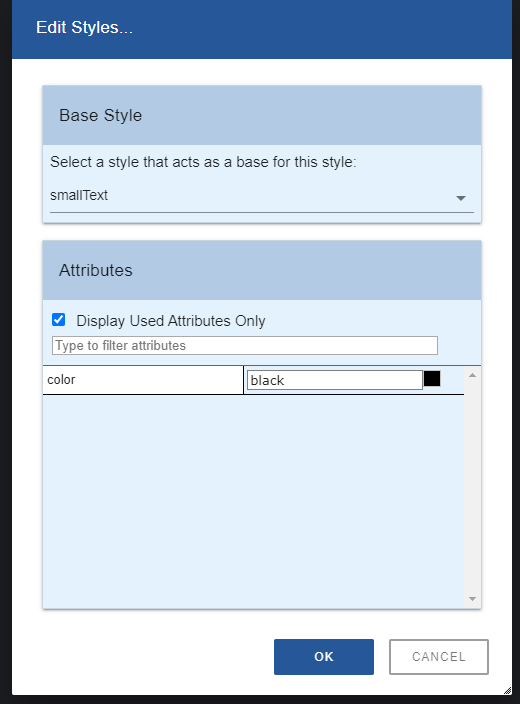

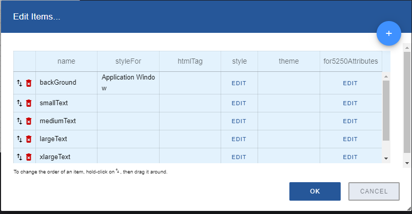

Set up Some Styles
Next you need to set up some base styles as part of your application.
Set them into your project by editing your application properties.
In this tutorial we are going to use these styles:
Which have these style property values:
Style Item Name
Property
Value to use (double check your values)
background
Background
#27282d
smallText
Font-Family
Font-Size
Color
Verdana
10pt
White
mediumText
Font-Family
Font-Size
Color
Verdana
10pt
White
largeText
Font-Family
Font-Size
Color
Verdana
10pt
White
xlargeText
Font-Family
Font-Size
Color
Verdana
10pt
White
errorMessage
Font-Family
Font-Size
Color
Verdana
10pt
Red
Define these base styles into your project and save your changes.

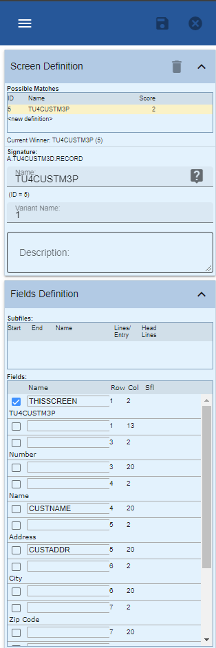

Call program TU4DRIVER – the tutorial 4 driver program written in free format ILE RPG. The source code for this program is in source file QTUTORIAL in library AXESDEMO. It has no parameters.
The resulting 5250 display will look like this - which may seem a bit strange at first.

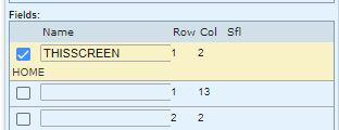

Identify this screen with the name HOME - the Suggest button will do this automatically or you can type the name in:
Now click on the first field on the screen (an output field at line 1 position 2 containing the word "HOME") to select it – name the screen field THISSCREEN.
Make sure to check the identification box for this field so that it is used as part of the screen signature to uniquely identify it.
Save your screen identification changes.

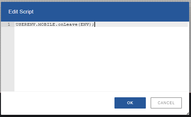

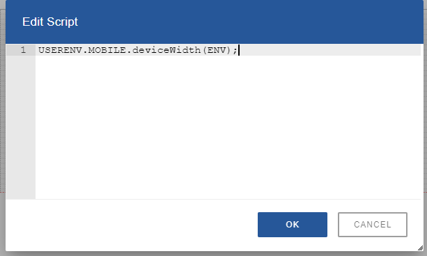

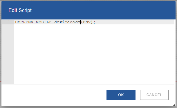

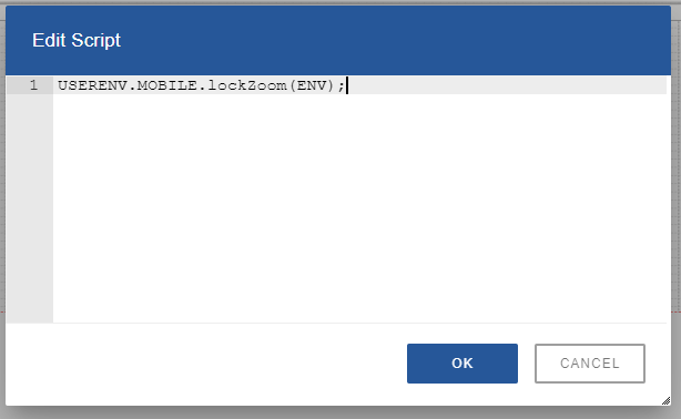

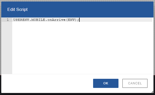

Hook up the USERENV.MOBILE.onArrive() and USERENV.MOBILE.onLeave() functions like this:

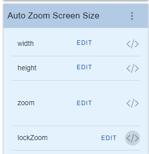

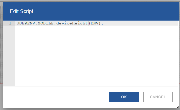

Then add an Auto Zoom Screen Size extension to the screen and hook up all the USERENV.MOBILE sizing functions - like this:
Edit width:
Edit height:
Edit zoom:
Edit lockZoom:

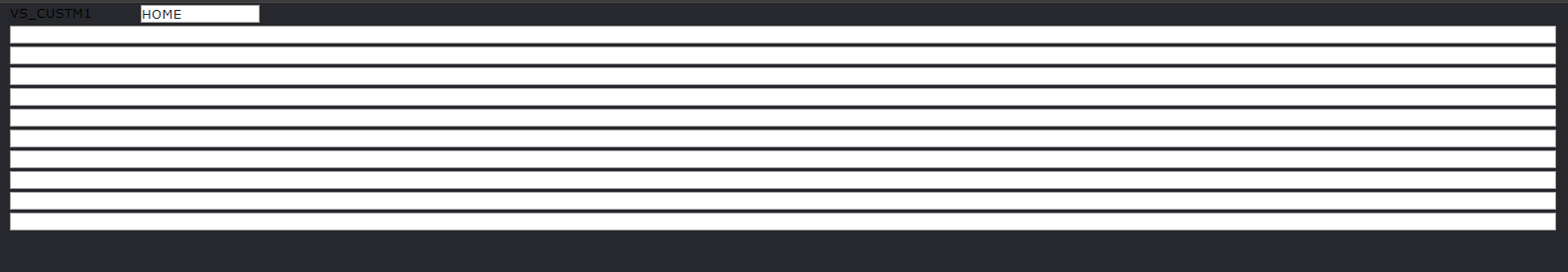

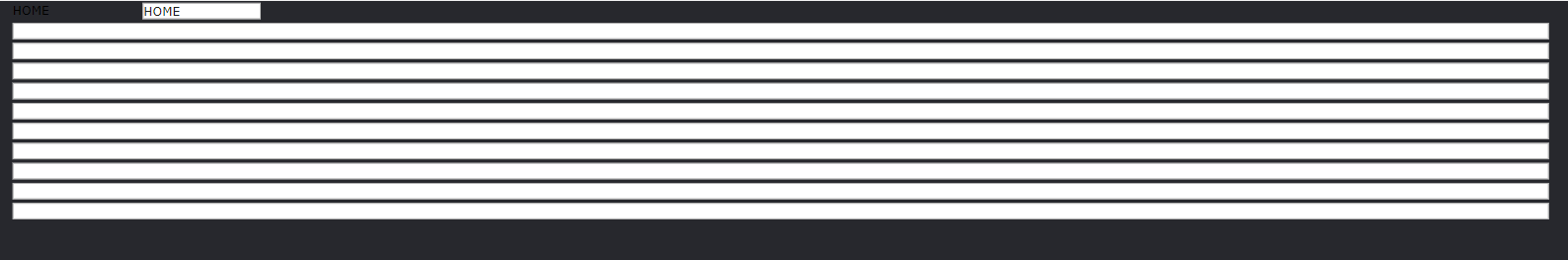

Next you need to hide every 5250 field on the screen.
You do this by selecting each field and un-checking its default visualization extension - like this:
  è
Note: Also make each field invisible.

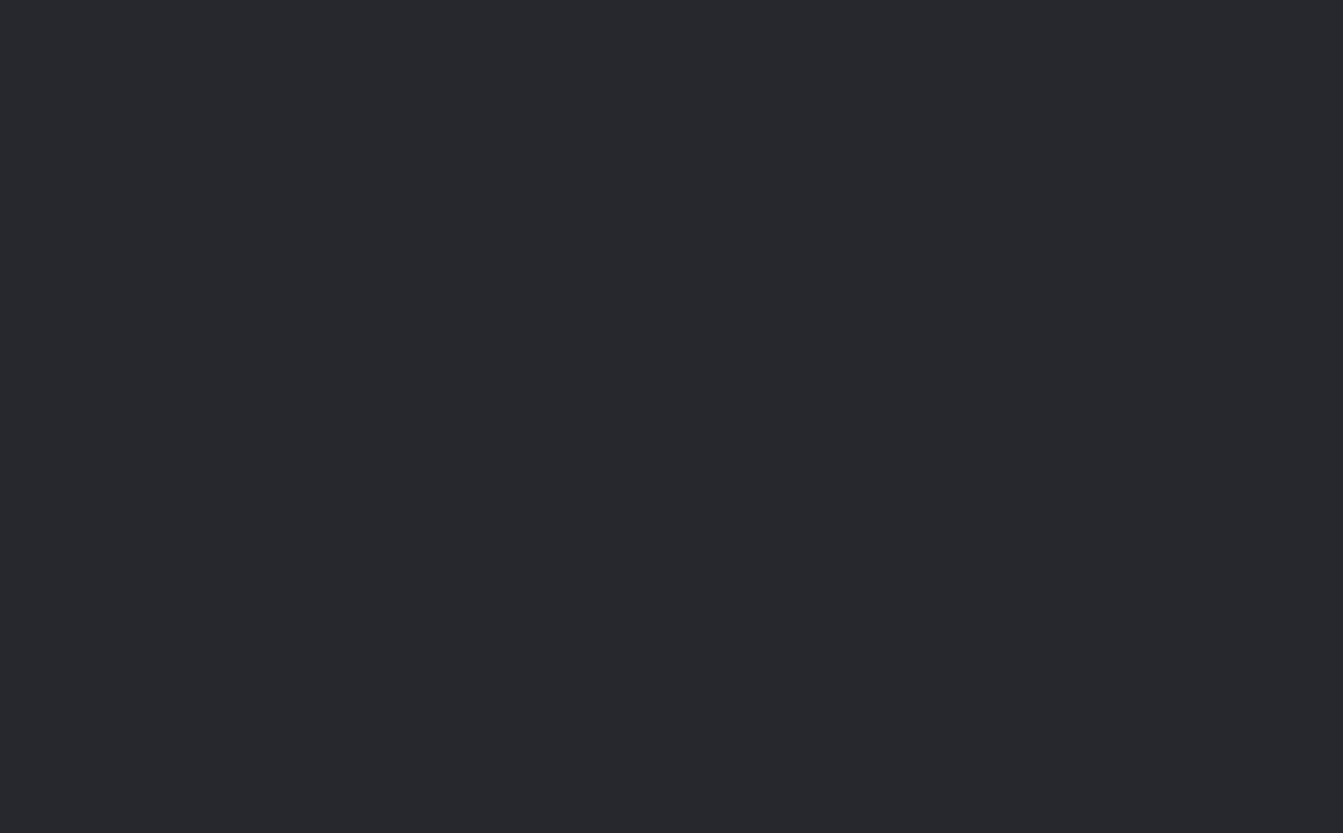

When you save your changes you should see a completely blank screen.

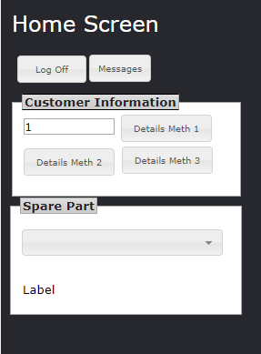

This is a blank "virtual screen" canvas for you to start painting on:
Make sure that your screen is this dark colour.
In the following steps we are going to insert white text onto it.
If you start inserting white text onto a white background things can become very confusing!

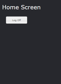

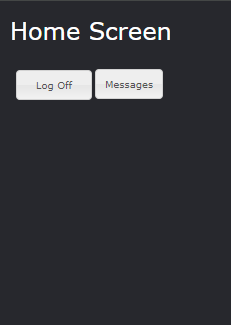

Now add a label eXtension to your screen captioned Home Screen.
Use the xlargeText base style for the label to make it use the large white font.
Then add a push button eXtension captioned Log Off to your screen.
The screen should now look something like this:
Change the onClick property of the push button to execute this script:
USERENV.MOBILE.gotoScreen(ENV,"EXIT");
The gotoScreen() function puts the string "EXIT" into the 5250 screen and sends the enter key. This tells the driver program TU4DRIVER to end.
Save your changes and then click the Log Off button – you should be returned to where you called the program TU4DRIVER from.
Note: In a real application a program like TU4DRIVER would be called automatically when the user signs on - so when TU4DRIVER ends the user would be logged off from the system.  More on this later.
You should now be able to call up the TU4DRIVER program, which will display your HOME page, and then end it again by clicking the Log Off button. Please ensure you can do this easily by repeating the process several times before proceeding with this tutorial.
You have now created a Home Page for your application.

Screen onArrive and onLeave events execute correct USERENV.MOBILE functions:
onArrive
USERENV.MOBILE.onArrive(ENV);
onLeave
USERENV.MOBILE.onLeave(ENV);

Auto Zoom Screen Size has been set up like this:
(the properties need to be set to evaluate script mode)
width
USERENV.MOBILE.deviceWidth(ENV);
height
USERENV.MOBILE.deviceHeight(ENV);
zoom
USERENV.MOBILE.deviceZoom(ENV);
lockZoom
USERENV.MOBILE.lockZoom(ENV);

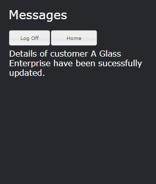

Setting Up a Messages Screen
It's useful to have a generic messages screen in smart phone applications.
To set up a messages screen do the following:
Call program TU4DRIVER to display your Home Page.

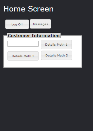

Add a new push button to your Home Page captioned Messages that calls a Message screen when clicked.
USERENV.MOBILE.gotoScreen(ENV,"MESSAGE");
Save your changes. Your home screen should now look something like this:
This is a brand new blank canvas virtual screen (more about them later).
This screen should be named MESSAGE.

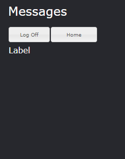

Complete the preceding New Screen Checklist to set this screen up for proper smart phone operations – you should end up with a completely blank screen.

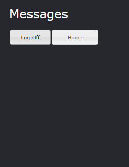

Now add a new label eXtension ("Messages") and two new push button eXtensions ("Home" and "Log Off") to your messages screen.
The Home button should do this when clicked or touched:
      USERENV.MOBILE.gotoScreen(ENV,"HOME");
The Log Off button should do this when clicked or touched:

Your MESSAGE screen should now look like this:
Save your changes.
Now add a new label eXtension to the middle of your MESSAGE screen - something like this:
Use base style mediumText so that text is largish and easy to read.
Now change the text property of the label so that the content it is dynamically created.
The script you need to use is something like this:
var text = "";
for (var i = 1; i <= 10; i++) { text += USERENV.MOBILE.getINFO(ENV,i); }
if (text == "") text = "No messages are available at this time.";
ENV.returnValue = text;
What this script does is retrieve the contents of the hidden 5250 fields and assemble them into one long text string. The resulting string is displayed in the label eXtension.
Save your changes.
You should now be able to start up the smart phone application by calling TU4DRIVER to display your HOME screen.
From the HOME screen you can display the MESSAGE screen, and from there you can go back to the HOME screen or EXIT (log off).
Please check you can do all these things before proceeding.

Start aXes as a developer and call program TU4DRIVER to display your HOME screen.
Add to your HOME screen:
  • A group box eXtension,
  • An input field eXtension (= default visualization)
  • Three push buttons eXtensions
Position, style and label them like this:
You need to set the style of the group box to use a white font.

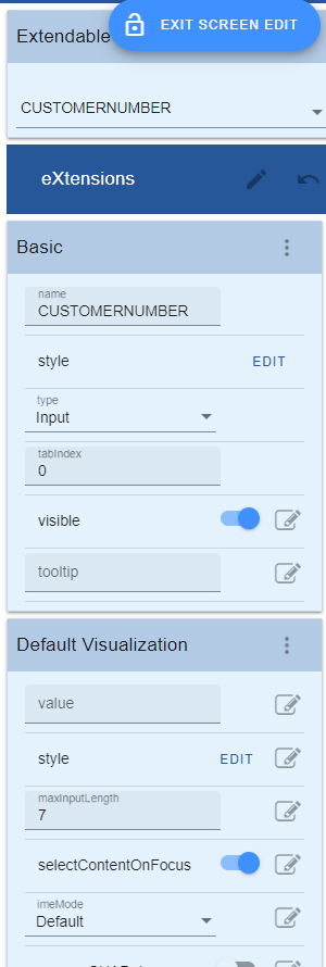

Make sure that the input eXtension is:
·         named CUSTOMERNUMBER
·         has its maximumInputLength property set to 7
Like this:
Save your customization changes.
Optional Technical Notes:
Try clicking your three new Details push buttons - notice how nothing happens?
This is because your home screen has on onLeave function like this:
If you look at the onArrive and onLeave functions in USERENV.MOBILE they do this:
             onArrive : function(env)
                USERENV.MOBILE.screenSendEnabled = false;
             onLeave : function(env)
                env.returnValue = USERENV.MOBILE._screenSendEnabled;
Every time a screen arrives the property USERENV.MOBILE.screenSendEnabled is set to false.
Every time the screen tries to leave (e.g.: when you click one of the new Details buttons) the current value of USERENV.MOBILE._screenSendEnabled is returned back to the aXes driver to indicate whether to proceed or not.
So when you click one of the new Details buttons the value being returned is false – so the request to send details to the server (i.e.: leave this screen) is ignored.

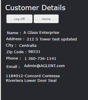

The will cause a brand new screen named VS_CUSTM1 to be displayed, something like this:
You should recognize this type of screen now – it is a "blank" virtual screen that you have decided to name VS_CUSTM1.
Set VS_CUSTM1 up in the normal manner by completing all the steps in the preceding New Screen Checklist table.
Then add a title Customer Details and also Home and Log Off buttons to your new VS_CUSTM1 screen so that you have a blank canvas starting point like this:
The Log Off button's script should do this: USERENV.MOBILE.gotoScreen(ENV,"EXIT");
The Home button's script should do this: USERENV.MOBILE.gotoScreen(ENV,"HOME");
Check that your buttons work as expected.
Now add and style a label eXtension on the screen that has text property "Name:".
Then add and style another label eXtension beside it.
Set its text property by evaluating this script:
        ENV.returnValue = USERENV.MOBILE.currentCUSTOMER.CUSTNAME;
Save your changes.
You should see a customer name appear on the screen like this:

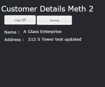

The resulting screen should look something like this:
By now you should be able to identify this as a new virtual screen named VS_CUSTM2.
You can also see the information returned by RPG program TU4CUSTM2P (or your version).
On the new virtual screen named VS_CUSTM2 you should now complete these steps:
·         Complete the preceding New Screen Checklist activities.
·         Add and style a title like "Customer Details Meth 2"
·         Add a Home push button that does USERENV.MOBILE.gotoScreen(ENV,"HOME");
·         Add a Log Off push button that does USERENV.MOBILE.gotoScreen(ENV,"EXIT");
·         Add and style a label with text property "Name:"
·         Add and style a label beside the name that sets its text by executing the script ENV.returnValue = USERENV.MOBILE.getINFO(ENV,2);
·         Add and style a label with text property "Address:"
·         Add and style a label beside the name that sets its text by executing the script ENV.returnValue = USERENV.MOBILE.getINFO(ENV,3);
The result should look something like this:
By adding more labels you can display the values of 5250 fields INFO_4 (City), INFO_5 (Zip Code), INFO_6 (Phone Number) and INFO_7 (Email address) by using the getINFO(ENV,N) function to retrieve the values. This equates directly to these lines in the RPG program TU4CUSTM2P (or your version of it):
          info_1 = %char(CustNumbr);
          info_2 = CustName;
          info_3 = CustAddr;
          info_4 = CustCity;
          info_5 = CustZip;
          info_6 = CustPhone;
          info_7 = CustEmail;

This time the screen displayed is not a virtual screen – it is a real 5250 screen presented by program TU4CUSTM3P according to the DDS defined in display file TU4CUSTM3D.

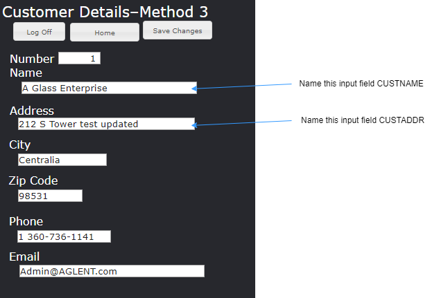

By now you should know the drill – HOWEVER – in this case most of the fields on the screen should not be hidden.
Fields THISSCREEN (line 1 pos 2), NEXTACTION (line 1 pos 13) and ERRORMSG (line 10 pos 20) should be hidden - all of the other fields should be left visible.
Additionally, the long error message field name on line 10 at position 20 should be named ERRORMSG in the aXes screen definition, like this:
Save your screen definition changes after you apply a name to the ERRORMSG field.

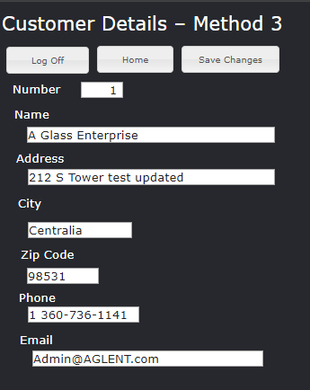

Now you should:
  • Complete the New Screen Checklist
  • Add a screen title "Customer Details – Method 3".
  • Add the standard "Log Off" and "Home" push buttons
  • Move and size the other label and input fields. Style the labels.
  • Add a "Save Changes" push button. Execute this script when it is clicked:
USERENV.MOBILE.gotoScreen(ENV,"TU4CUSTM3P");

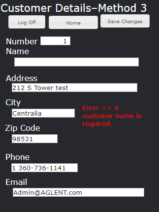

The resulting screen looks something like this (note that it has slightly different style to the screens used in the preceding tutorial steps):
Save all your screen customization changes.
Now add a label eXtension to your screen and apply base style errorMessage to it, position it in a free area on your screen – something like this:
Change it so that its text property is derived by executing this script:
ENV.returnValue = "";
sError = FIELDS("ERRORMSG").getValue();
if (sError != "NONE") ENV.returnValue = "Error =>" + sError;
This script gets the value of the field you named ERRORMSG (which is hidden from view) and puts its value into the eXtension – providing that it does not contain the message "NONE".
The end result is that when you try to update a customer with a blank name, address or phone number the messages are made visible to the user …
Save your customization changes and test your new screen. Try saving after blanking out the customer name.

Notice that when you update a customer screen your MESSAGE screen is displayed to confirm the action to the user:
Doing this type of positive confirmation of user's actions is useful on smart phones where variable response times are common.
The "Messages" button on your Home screen is now redundant.
In this application there is no reason for the user to display the messages (and in fact it may show incorrect details at times). Confirmation messages are presented automatically by the application when it is appropriate.
Remove the "Messages" button from your home page now and save your changes.

In the preceding Customer Details – Method 3 example data validation is performed by server RPG program TU4CUSTM3P. You can also easily do client side validation. Display your Customer Details – Method 3 screen and name the input fields as indicated.
Since these are real 5250 screen fields and not newly added eXtensions you name them here:
Save your changes.
Now locate the screen level onLeave property and change it to execute this script:
var CUSTNAME = FIELDS("CUSTNAME").getValue();
var CUSTADDR = FIELDS("CUSTADDR").getValue();
var errormessage = "";
if (CUSTNAME == "") errormessage += " You must specify a customer name.";
if (CUSTADDR == "") errormessage += " You must specify a customer address.";
if (errormessage != "")
   alert(errormessage);
   ENV.returnValue = false; /* Stop send of data to server */
else
Save your changes.
You should now not be able to save customer changes unless you have specified a name and address – and when the data is invalid it is stopped before it is sent to the server.

Edit the USERENV object and add a new property to your USERENV.MOBILE object definition:
             currentCUSTOMER   : null,
             HOME_CustomerNumber :"1" /* Remembered Customer Number */
             deviceWidth       : function(env) { env.returnValue = 320; },
Save your USERENV changes and follow any restart instructions.
On your home page the field where they enter the customer number is named CUSTOMERNUMBER:
Change the field CUSTOMERNUMBER to derive its value by executing this script:
         ENV.returnValue = USERENV.MOBILE.HOME_CustomerNumber;
   if (USERENV.MOBILE.HOME_CustomerNumber != null)
      FIELD.setValue(USERENV.MOBILE.HOME_CustomerNumber);
Change the onLeave event of your home page to be like this:

Then add the highlighted lines to your USERENV.MOBILE object definition:
             lockZoom          : function(env) { env.returnValue = true; },
             curAXMBPART : null,  /* Reference to current AXMBPART row */

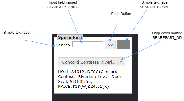

Now that we have a table of spare parts available and a reference to the "current" spare part it is easy to show the user what it is and also allow them to change it.
Add a group box, a drop down and a label field to your home page, something like this:
Name the label field SPARE_DETAILS
Then change its text property to be evaluated by executing this script:
var Text = "No spare part details are available";
var P = USERENV.MOBILE.curAXMBPART;
if (P != null)
   Text = "NO:" + P.PARTNUMBR;
   Text += ", DESC:" + P.PARTDESC;
   Text += ", STOCK:" + P.PARTAVAIL;
   Text += ", PRICE:$" + P.PARTWHOLE + "(W)$" + P.PARTRETL + "(R)";

Display your Customer Details – Meth 1 screen and add a label eXtension like this:
Change the text property of the new label to be dynamically evaluated by this script:
if (P != null) Text = P.PARTNUMBR + "-" + P.PARTDESC;
ENV.returnValue = Text;
You should find that the Customer Details – Meth 1 screen displays the details of whatever spare part was selected on the home screen, like this:

Now alter your home screen like this:
Double check that you have:
·         Named the input field SEARCH_STRING
·         Named the small blank label to the right SEARCH_COUNT
·         Named the drop down SPAREPART_DD
Select the "Go" push button to execute this script when clicked:
var SearchValue = FIELDS("SEARCH_STRING").getValue().toUpperCase();
if (SearchValue == "")
   alert("You need to enter a search value");
else
   TABLEMANAGER.loadDynamicTable("AXMBPART-DYNAMIC",USERENV.dynamicTablesFile,{SQLVariable_DESC:SearchValue});
   var table = TABLEMANAGER.getTable("AXMBPART-DYNAMIC");
   FIELDS("SEARCH_COUNT").setProperty("text",("Found " + table.childCount().toString()));
   USERENV.MOBILE.curAXMBPART = table.child(0);
   FIELDS("SPAREPART_DD").refresh();
   FIELDS("SPARE_DETAILS").refresh();
   FIELDS("SEARCH_COUNT").refresh();
This script:
·         validates what has been input to the SEARCH_STRING field.
·         Executes the "AXMB_PART-DYNAMIC" SQL command defined earlier – substituting the SQLVariable_DESC with the user's SEARCH_STRING value.
·         Updates the SEARCH_COUNT label's text property with a count of how many rows were found by the SQL command.
·         Updates the "current" spare part reference (USERENV.MOBILE.curAXMBPART) to point to the first row of aXes table that the SQL command produced.
·         Asks the drop down, spare parts details and search count label all to refresh their displays with the updated information.
Finally change the static table (yes, static table) source for the drop down SPAREPARTS_DD to be from AXMBPART-DYNAMIC - like this:
Save all your changes.
You should find that you can now search by clicking the "Go" button for words like "valve" or "agit" to find various spare part valves and agitators ….
In this simple example you have now managed to produce a generically searchable spare parts stock/cost enquiry – all managed and presented in a very small and dense screen area.

Using a "Flat" Screen Navigation Model
In 5250 applications the use of complex program call stacks is common. You log on to Menu A, then option 6 calls up Menu B, where option 2 calls up Menu C, where option 4 calls up the Order Inquiry program. You now have 4 programs all active and in a complex program stack. This is called "stateful programming". In many respects this type of stateful call stack implementation is unique to the IBM i community.
In smart phone designs you should try to minimize the use of stateful programming techniques. Such a change is actually very easy to make and will usually produce a simpler and far more flexible and extensible application. Additionally, any programs you produce may be very easily converted into servicing other things (e.g. web services) sometime in the future.
Using a Home Screen
You should use a single Home screen. Its role is:
  • The screen the user sees initially when they log on.
  • It is the place in which most interactions are initiated from.
  • All other screens should have a button that goes directly back to the home screen. This is something akin to using F12 on a 5250 screen or the Cancel button on a Windows form.
The home screen always has a log off button.
Log off from every screen
You should have a log off button on every screen.
Using a Messages Screen
You should use a single Messages screen. Its role is to show status, completion or error message details to the user. Normally it has only two buttons enabled. One to go back to the Home screen (allowing another activity to be initiated) and the other to log off.
