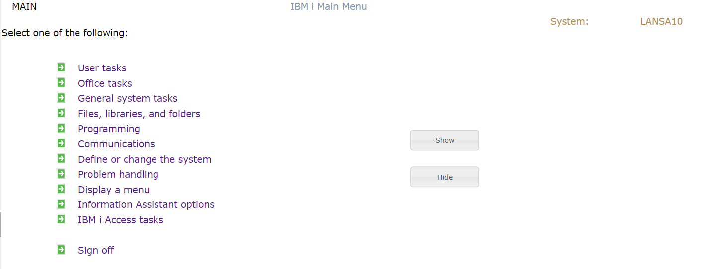

How can I hide AXES menu bar and status bar?
SHOWAXESMENUBAR and SHOWAXESSTATUSBAR functions control the visibility of menu & status bar. If you want to always hide the menu / status in your application, put the following code in the onApplicationStart event of your application.
SHOWAXESMENUBAR(false); // false = hide, true = show13;10;SHOWAXESSTATUSBAR(false);13;10;

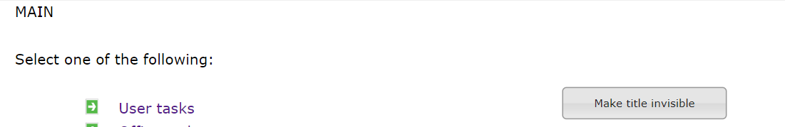

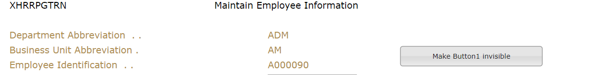

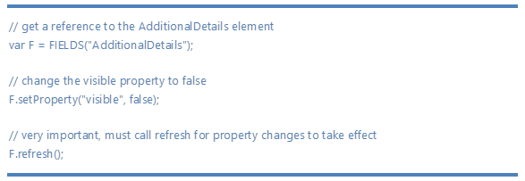

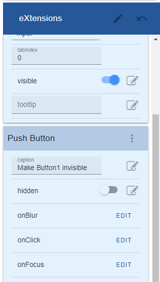

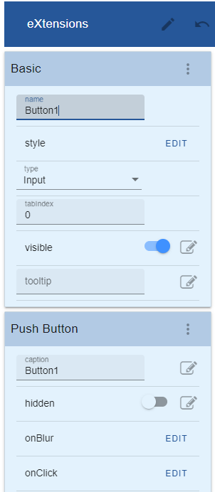

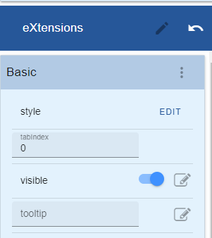

My script needs to change a property of an element’s eXtension at runtime. Can it do that?
Yes, using the setProperty method of the element.
For example, a script under a certain condition needs to hide another element named "AdditionalDetails". We can do this by setting the visible property of the element to false (visible property can be found in the property sheet under Basic Properties).
The script would look something like this:
// get a reference to the AdditionalDetails element13;10;var F = FIELDS("AdditionalDetails");13;10;13;10;// change the visible property to false13;10;F.setProperty("visible", false);13;10;13;10;// very important, must call refresh for property changes to take effect13;10;F.refresh();13;10;
Note the last line – you need to call the refresh method of the element after changing a property of an element in order for the changes to be reflected visually.
Note how this is different from changing the current value of an element (remember that every element has a text value) using the setValue method – call to refresh is not required after setValue.
To get a property value, use the getProperty method.
Example:

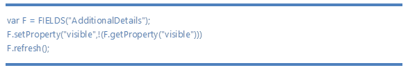

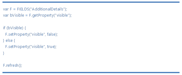

If you wanted to show/hide according to its current state – if visible à hide otherwise show:
var F = FIELDS(AdditionalDetails);13;10;var bVisible = F.getProperty(visible);13;10;13;10;if (bVisible) {13;10;  F.setProperty(visible, false);13;10;} else {13;10;  F.setProperty(visible, true);13;10;}13;10;13;10;F.refresh();13;10;
Note: you could write the above in only 3 lines of code:
var F = FIELDS(AdditionalDetails);13;10;F.setProperty(visible,!(F.getProperty(visible)))13;10;F.refresh();13;10;
For more detailed information about getProperty and setProperty methods refer to the Scripting Reference.

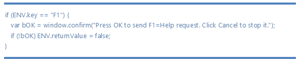

Yes. Try this example as the onLeave script in a customized screen:
if (ENV.key == F1
 When F1 is used this script confirms the usage - selectively cancelling it by setting ENV.returnValue = false;

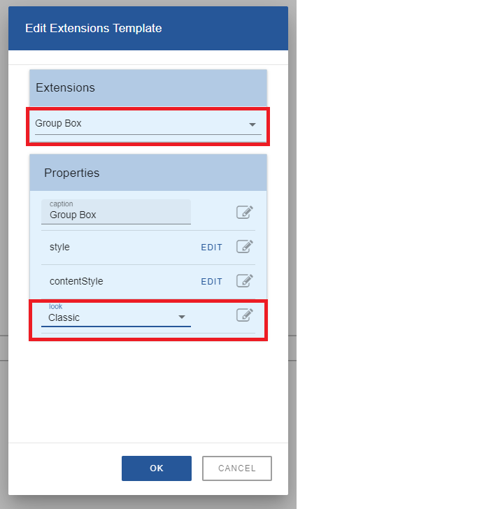

I want to always use the “Modern” look for all my group box eXtensions, can I do this without having to change the “look” property of each group box?
Yes. However, this feature is only available in TS2 Developer (TS2 Developer aXes 311.001 and latest releases).
When an eXtension is applied to a screen element, it is created based on a template. Every eXtension template is customizable – so what you need to do is to customize the group box template. Follow these steps to change the group box template’s “look” property to “modern”:

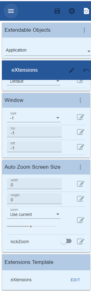

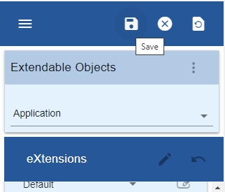

TS2 Developer
1.       Select Application from the Extendable Objects dropdown list in Developer and eXtensions tab. Click Edit Items button of the eXtensions property at Extension Template section.
2.       Edit Extensions Template window will appear. showing customizable eXtensions and a property sheet showing their current default values. Select Group Box in the drop down. Change the “look” property from ”Classic” to “Modern”. Click Ok button to close the window.
3.       Now click the Save button to save the change you made on Application properties.
Now whenever you apply the gup box eXtension to a screen element, you will see that the “look” property is always set to “Modern” by default.

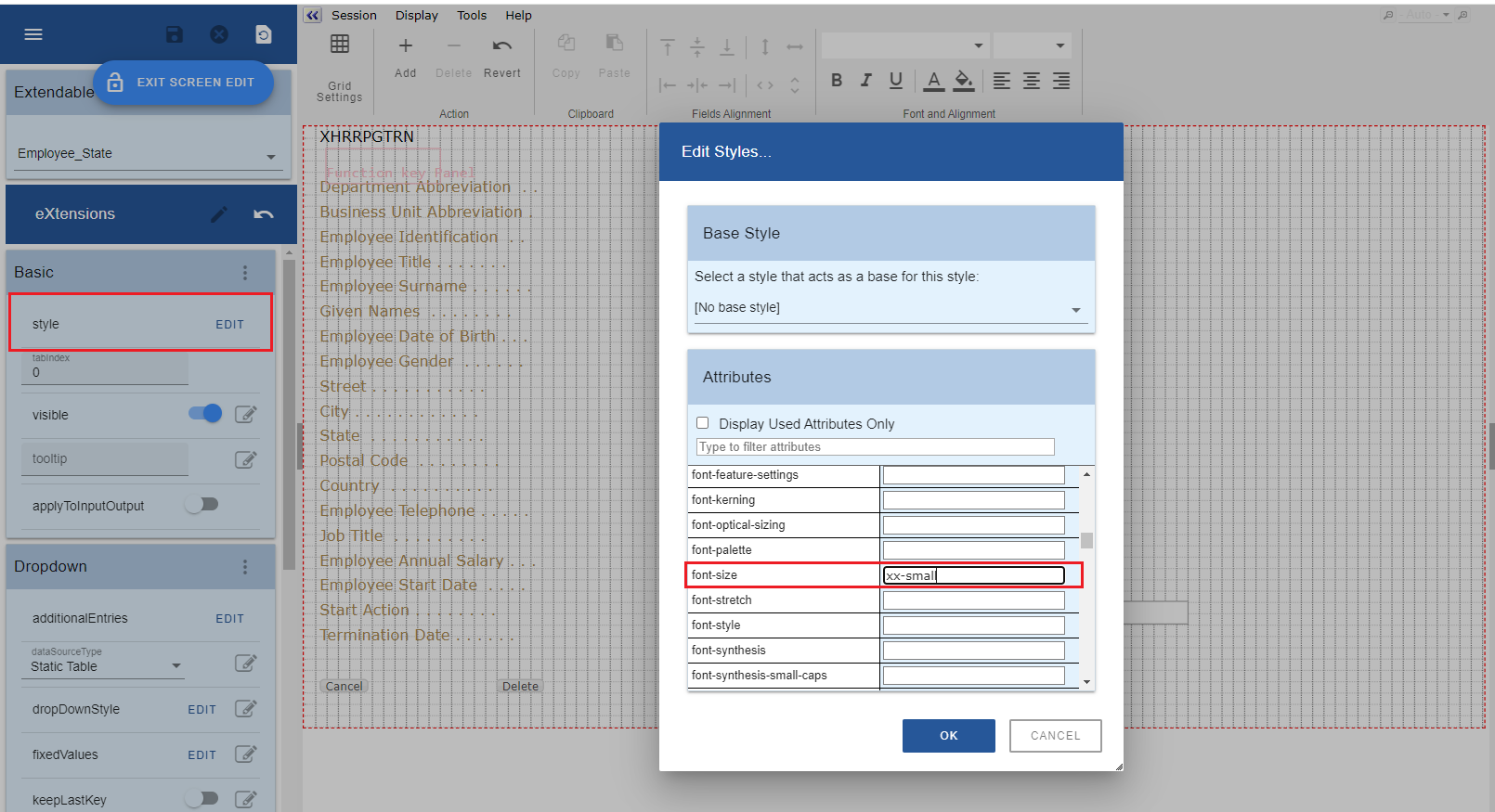

-          The “style” property of various eXtensions (e.g. button eXtensions) is a particularly good example of a property that should be set once only in the template as you would normally want all buttons to have the same style.
When I change the default “style” property of button eXtension, would this affect those buttons I created prior to this point?
Yes – as long as you haven’t modified the “style” property of those buttons. Remember that AXES physically stores only values that are different from their default values. So if you put various button eXtensions on your screen and you didn’t touch the “style” property of those buttons, any changes made to “style” property in the button template will immediately be reflected in all existing button instances.

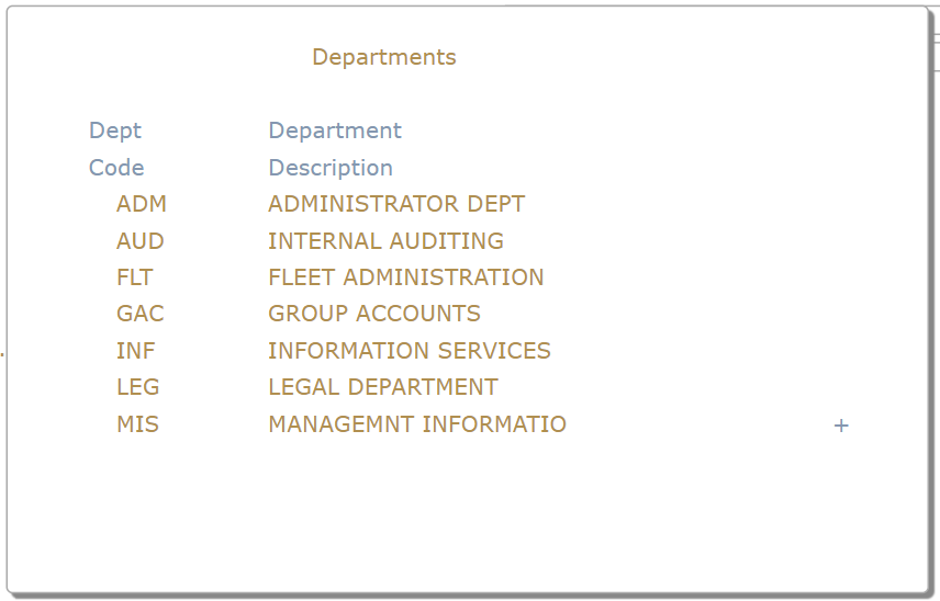

When I start customizing a popup screen, it completely covers the whole screen, is this normal?
Yes. Popup screens will only show the previous screen in the area surrounding the popup if the popup screen is uncustomized. Once you start to customize a popup screen, it will cover up the surrounding area.
I have customized a screen (screen A) that can invoke a popup (screen B). When the popup appears, what was shown in the background is the original uncustomized screen A instead of the customized one. What should I do?
From version 2.1.11 onwards aXes-TS2 will keep the background customizations. Check that this has not been turned off with the popups parameter of the axes URL. See Keeping the Background Customizations.
In aXes-TS1 make the popup screen (screen B) into a customized screen - even when you don’t change anything in the popup screen.
See the FAQ item above – when a popup screen (screen B) is customized, it will completely cover the whole screen & the previous screen (screen A) will not show in the background anymore.
My popup is making use of the cursor to allow the user to select an item from a list, how will this work after the screen has been customized as the cursor does not show anymore?
If your popup allows the user to select a value by displaying a list of values, and the user selects one by putting the cursor on the list entry and pressing enter, then the best alternative is to customize the popup screen and add a hyperlink extension to the first field in the popup's list, as explained in the section above (Example – Working with 5250 Cursor).
You could also enable the limitedCursorSupport option on the popup screen, though visually, the first option is much better. Note that the limited cursor support is meant as a temporary measure only and should not be used as a permanent solution.
If you are enabling the limitedCursorSupport, make sure that you set the keepPopupLocation property of the popup screen to true.

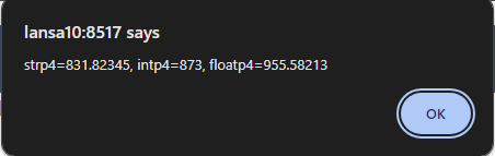

var result = TABLEMANAGER.callProgram("LOTST002","QGPL",
                  { type:"packed",len:7,dec:0,value: 4 },
                  { type:"packed",len:9,dec:2,value: 7.7 },
                  { type:"packed",len:12,dec:5,value: 820.12345 },
                  { type:"packed",len:15,dec:5,pass:false,ret:true } );
if (result.error) alert("Call Failed");
else
  var strp4   = result.returnParms[4];         /* Should be 831.82345 as string */
  var intp4   = parseInt(strp4,10) + 42;       /* Should be 831 + 42 = 873 */
  var floatp4 = parseFloat(strp4) + 123.75868; /* Should be 955.58213 as float */
  alert("strp4=" + strp4 + ", intp4=" + intp4.toString() + ", floatp4=" + floatp4.toString());
Result
Note that the returned parameter (strP4) is a always a string. By using the standard JavaScript functions parseInt() and parseFloat() it can easily be converted to a number for further manipulation by JavaScript code.

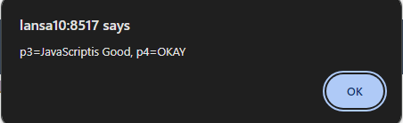

Example 5 – Value Passed and Returned in same Parm
Server CL program
This small CL program named LOTST005 sends a message to the system operator and returns "OKAY":
PGM (&P1)
DCL &P1 *CHAR 20
SNDMSG     MSG(&P1) TOMSGQ(QSYSOPR)
CHGVAR &P1 'OKAY'
ENDPGM
Button onClick JavaScript coding in Axes

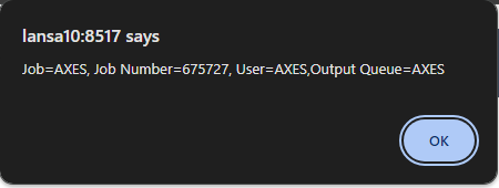

var message = "Hello from LOTST005";
var result  = TABLEMANAGER.callProgram("LOTST005","QGPL",
                 {type:"alpha",len:20,pass:true,ret:true,value:message} );
else alert(result.returnParms[1]);
Result
var p1 = "JavaScript";
var p2 = "is Good";
var result  = TABLEMANAGER.callProgram("LOTST007","QGPL",
                 { type:"alpha",len:10,pass:true,value:p1  },
                 { type:"alpha",len:10,pass:true,value:p2  },
                 { type:"alpha",len:20,pass:false,ret:true },
                 { type:"alpha",len:10,pass:false,ret:true } );
else
   var p3 = result.returnParms[3];
   var p4 = result.returnParms[4];
   alert("p3=" + p3 + ", p4=" + p4);
Result

Button onClick JavaScript coding in Axes – Stage 1
var result = TABLEMANAGER.callProgram("LOTST010","QGPL",{type:"alpha",len:2000,pass:false,ret:true});
alert( result.returnParms[1] );
Result – Stage 1
The CL program LOTST010 is executed and it returns a long string with the job name, job number, user and output queue all imbedded in it.
In effect LOTST010 has returned 4 values, but done it using a single program parameter.
Note how the returned string is formatted in much the same way as the program arguments are specified in JavaScript - type:"alpha",len:2000,pass:false,ret:true
Button onClick JavaScript coding in Axes – Stage 2
try
   var Info = eval( "({" + result.returnParms[1] + "})" )
   window.alert("Job=" + Info.JOB + ", Job Number=" + Info.JOBNBR + ", User=" + Info.USER + ",Output Queue=" + Info.OUTQ);
catch (oe)
   window.alert( "Error " + oe.description + " detected when loading JSON data " + result.returnParms[1] );
Result – Stage 2
The value returned is in JSON string format.
The returned value is executed by using a JavaScript eval operation to create a JavaScript object named Info.
Now the properties Info.JOBInfo.JOBNBR, ,  Info.USER and  Info.OUTQ are all accessible to the JavaScript code. In effect the 4 values returned by CL program LOTST010 are now individually accessible as JavaScript object properties.

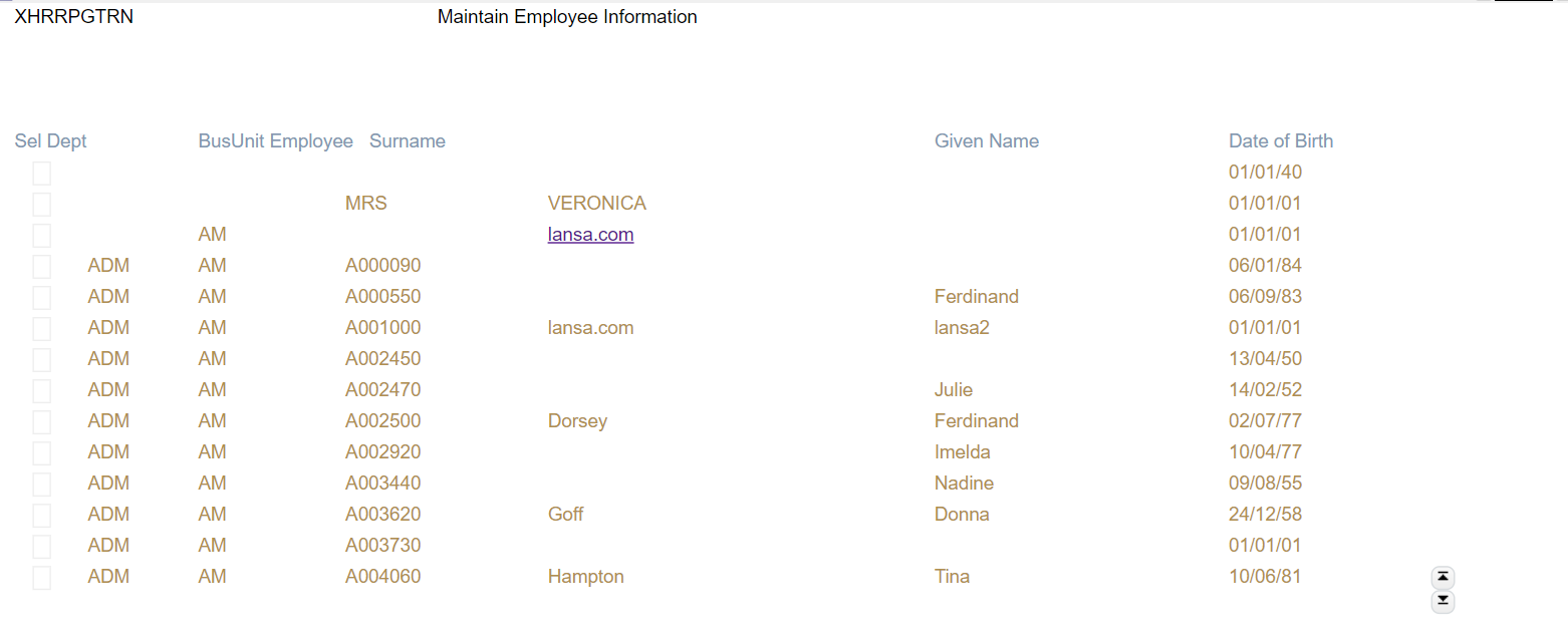

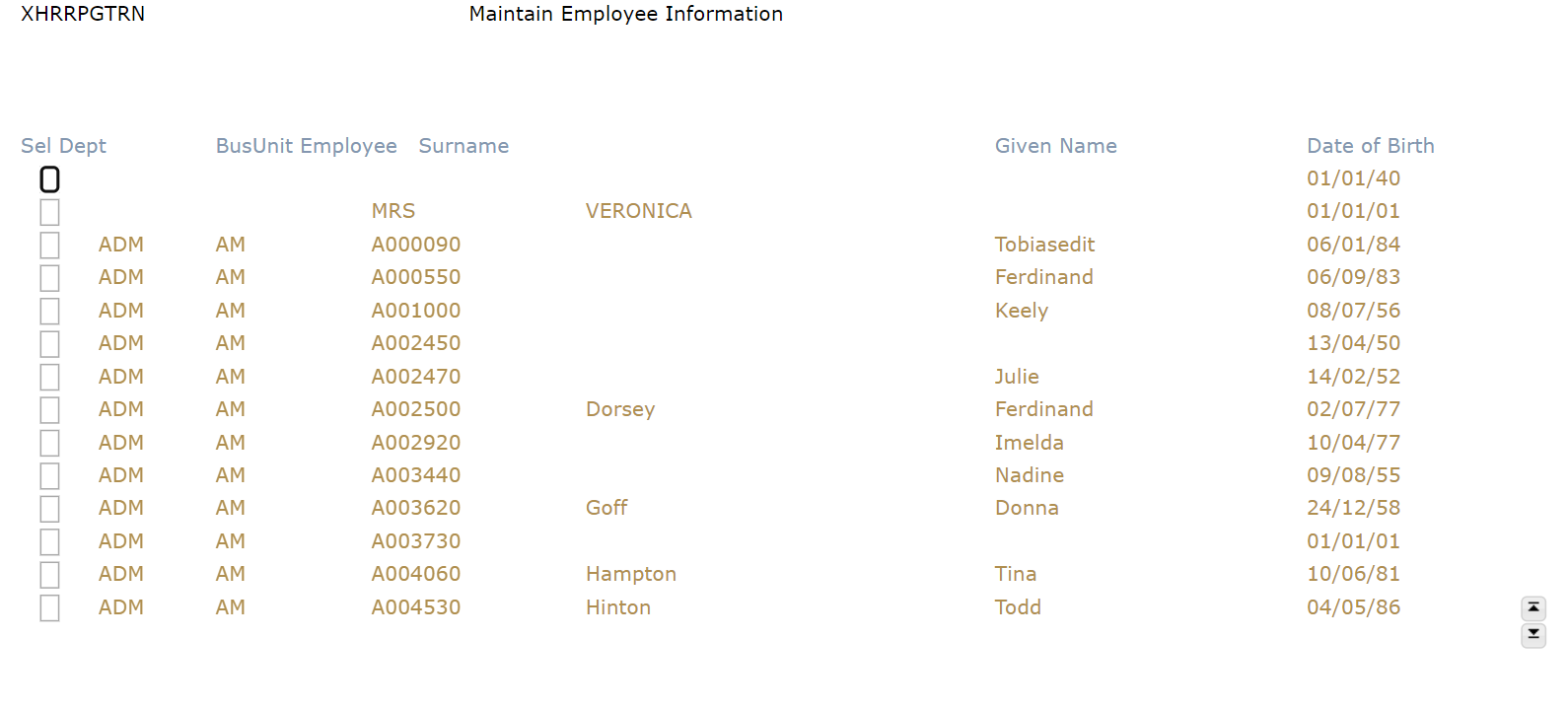

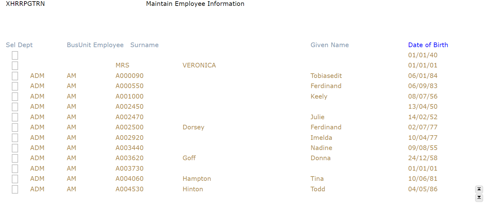

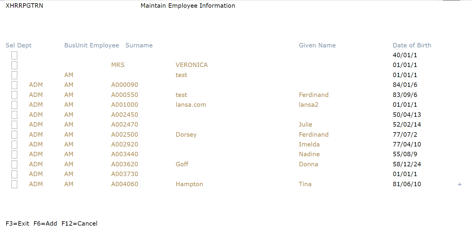

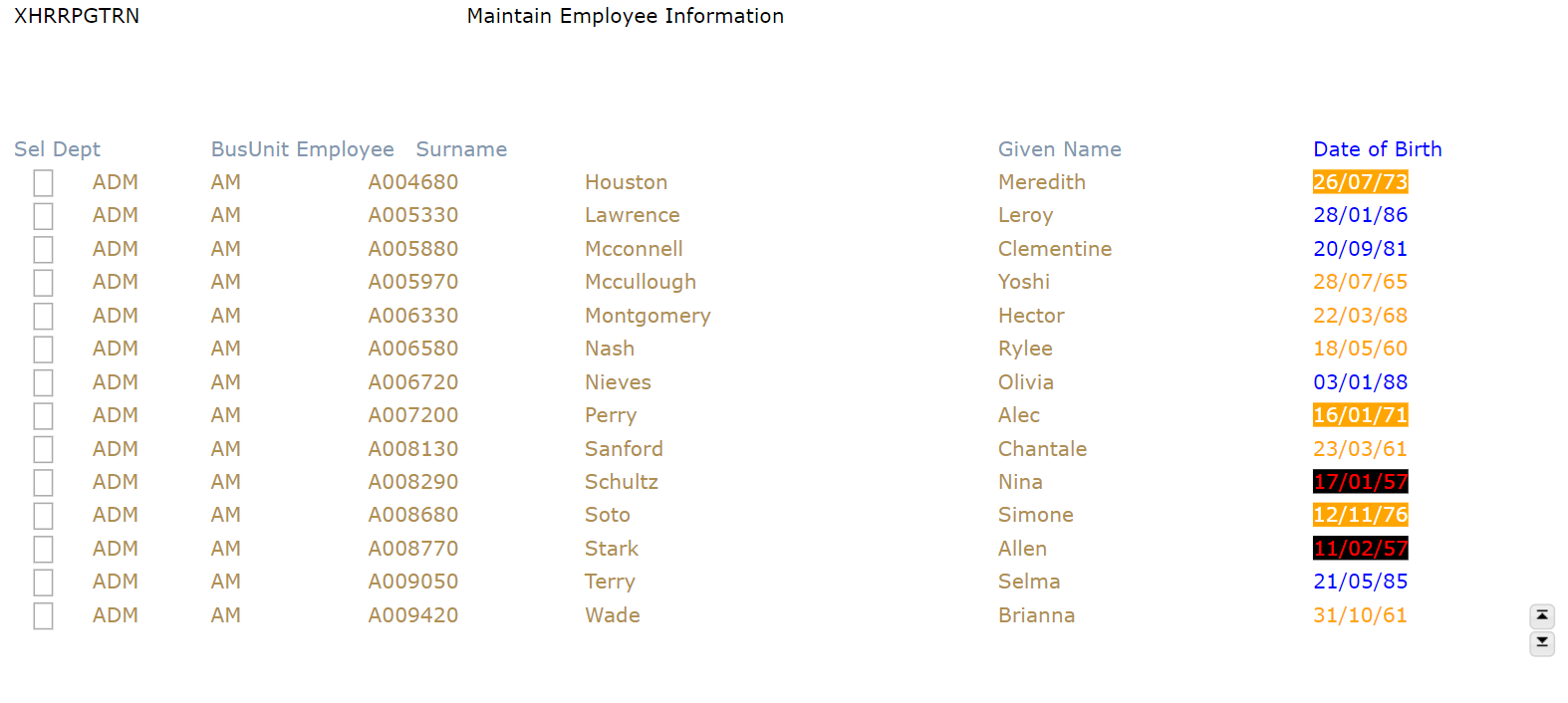

Example – Using a Hyperlink to select a subfile entry
Start Point
The shipped aXes demonstration screen named XHRRPGTRN_Select is used.
The subfile selection column is field named Sel and the employee number column is named Employee:
Result
The selection column is still visible, but an employee can be selected and displayed by clicking on the employee number hyperlink:
Steps
v  The employee column was selected and changed to be a Hyperlink.
v  These properties were then set in the hyperlink eXtension:
caption (script):
ENV.returnValue = FIELD.getValue();
style
onClick (script)
/* Find out the subfile index of this field (the one clicked on) */
var iSFLIndex = FIELD.getIndex();
/* Get a reference to the "Sel" field with the same subfile index */
var oSel = FIELDS("Sel",iSFLIndex);
/* If found, set the "Sel" field to "X" and press Enter */
if (oSel != null)
   oSel.setValue("X");
   SENDKEY("Enter");
mouseOverColor
red

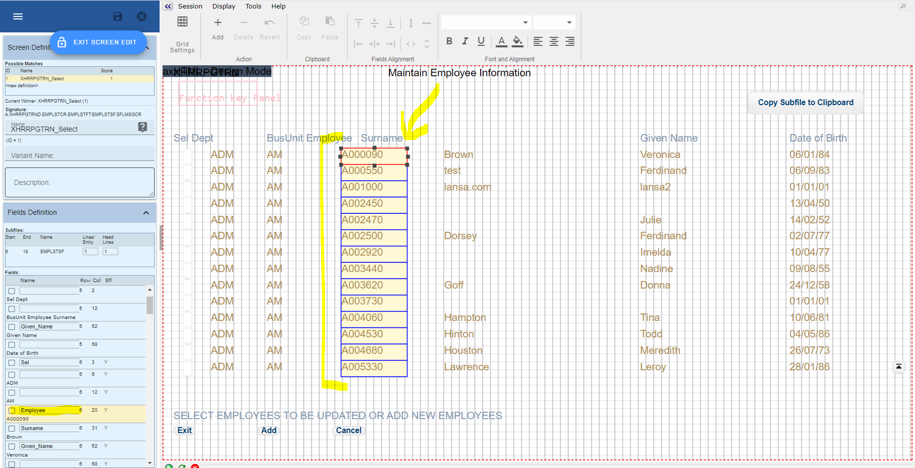

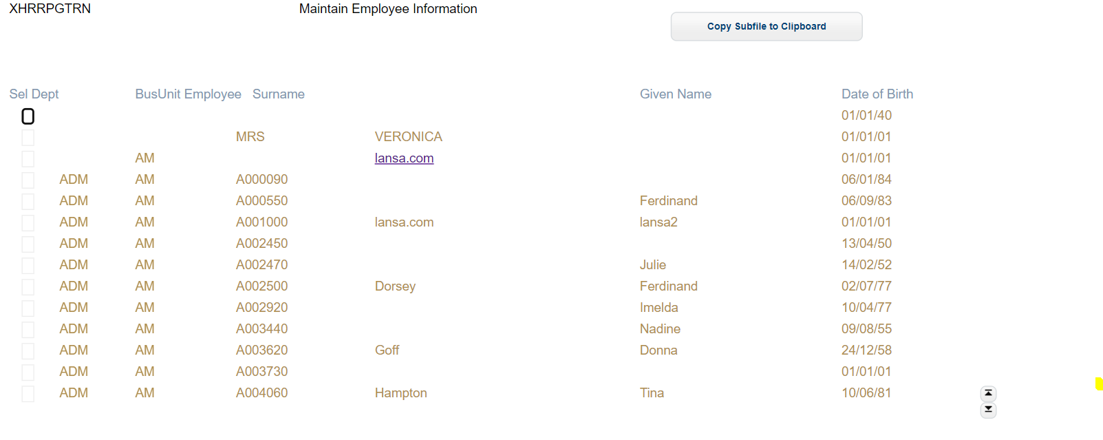

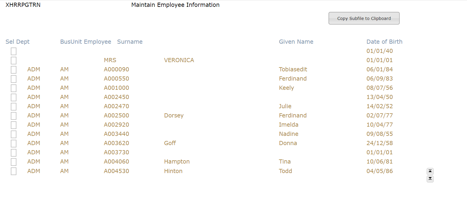

Example – Iterating through subfiles entries
Start Point
The subfile selection column field is named Sel, and the employee number, Surname and Given Name columns are named Employee, Surname and Given_Name respectively:
Result
A copy to clipboard push button has been added. When clicked all the subfile entries on the current screen are copied to the clipboard:
Steps
v  A new element was added to the screen as a push button.
v  These properties were then set in the push button eXtension:
Note: Also when naming fields in a subfile you need to select the first one so that the whole column get selected.
caption simple text):
Copy ubfile to Clipboard
onClick (script)

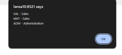

var sClipData = "";
var sTab      = "\t";
var iSFLIndex = 1;
while (oSel != null)
    if (oSel.getValue() == "C")
       var oEmployee = FIELDS("Employee",iSFLIndex);
       var oSurname = FIELDS("Surname",iSFLIndex);
       var oGivenName = FIELDS("Given_Name",iSFLIndex);
       oSel.setValue(" ");
       sClipData += oEmployee.getValue() + sTab;
       if (oSurname != null) sClipData += oSurname.getValue() + sTab;
       else sClipData += "UNKNOWN" + sTab;
       if (oGivenName != null) sClipData += oGivenName.getValue()   + sTab;
       sClipData += "\n";
    iSFLIndex += 1;
if (sClipData == "")
  window.alert("No employees were selected to copy. Put a C beside the employees to copy.");
else
  // window.clipboardData.clearData();
  // window.clipboardData.setData("Text",sClipData);
  alert(sClipData);
Observations
The employee number field was chosen to drive the subfile iteration loop because it exists for every subfile entry.
The subfile iteration loop is structured like this:
var iSFLIndex = 1;
while (oEmployee != null)
    << Process employee >>
    iSFLIndex += 1;
The loop starts at entry one and proceeds until an employee number cannot be found in the subfile.
When iterating a subfile the possibility exists that blank outfield entry will not actually exist on the 5250 display. That is why the logic
is used. It caters for the fact that an employee's surname may be blank and therefore the entry does not exist in the subfile.
The clipboard data is tab delimited so it can be pasted as columns to, for example, MS-Excel.
You would probably not code logic like this in a real application. It would be better to create a generic subfile clipboard function in your USERENV object and simply call it from the onClick routine.

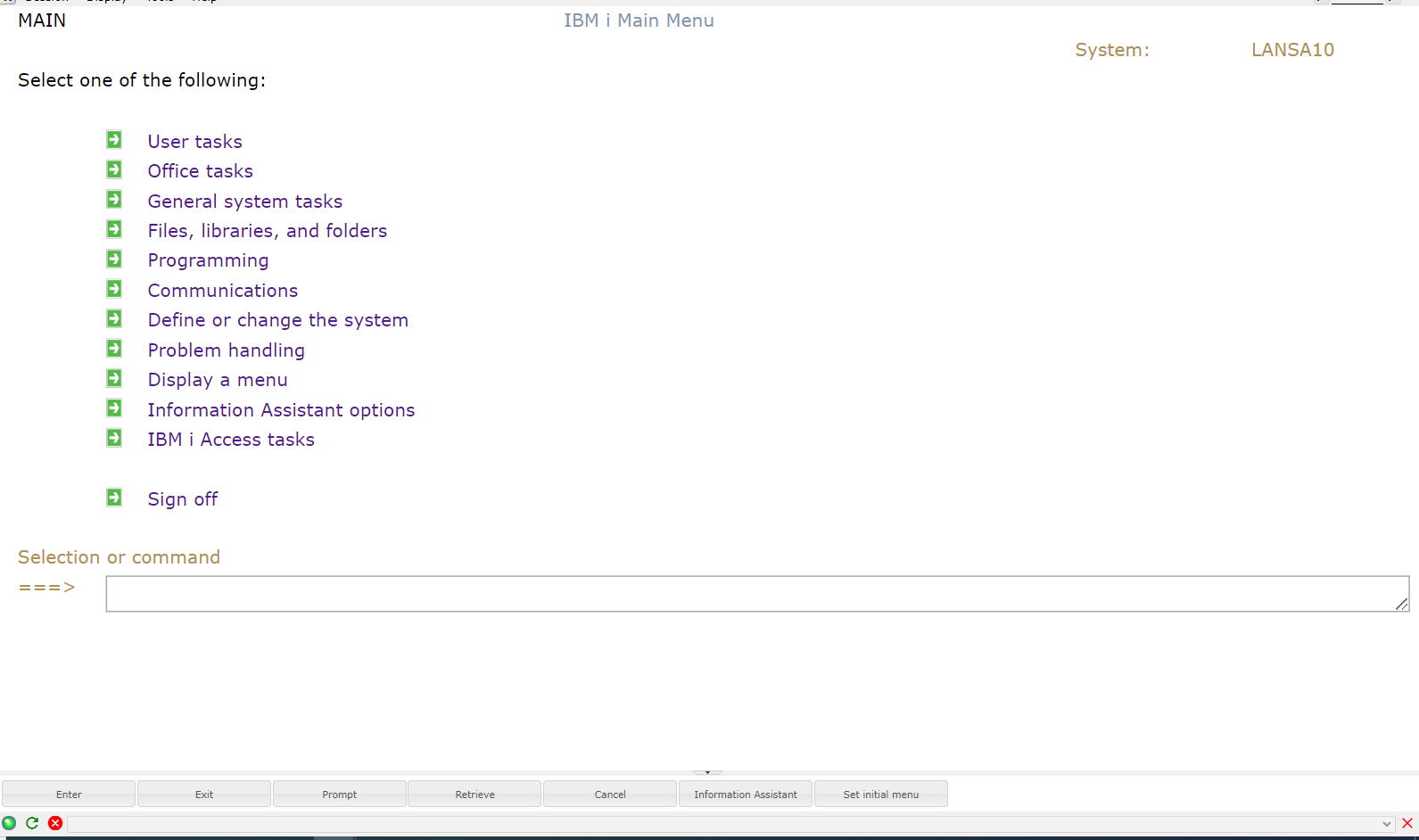

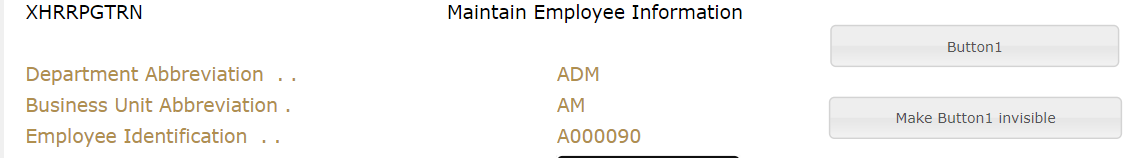

Example - Hiding and Showing Fields on a Customized Screens
The starting point for this example is the System i Main Menu, where:
v  The screen is named MAIN
v  The selection or command field is named CommandLine.
v  Two push button eXtensions, captioned Show and Hide, have been added.
The onClick property of the Show push button is set to this:
var cmdfld= FIELDS("CommandLine");
cmdfld.setProperty("visible",true);
cmdfld.refresh();
The onClick property of the Hide push button is set to this:
cmdfld.setProperty("visible",false);
cmdfld.refresh();
When clicked they cause the selection or command field (CommandLine) to appear and disappear.
You can minimize this type of scripting by adding two generic functions like this to your USERENV object:
   showField : function(env,name,index)
     var oField = env.FIELDS(name,index);
     if (oField != null)
         oField.setProperty("visible",true);
         oField.refresh();
   hideField : function(env,name,index)
      if (oField != null)
         oField.setProperty("visible",false);
         oField.refresh();
Now the onClick property of the Show push button may be reduced to this:
USERENV.showField(ENV,"CommandLine");
and the onClick property of the Hide push button reduced to this:
USERENV.hideField(ENV,"CommandLine");
You now have generic hide and show functions you can use on any field.

Example – Dynamic Styling
Start Point
Result
The style of the Date of Birth Column is changed dynamically to highlight people born in the 50s, 60s, and 70s. Dynamic styling is often used to draw attention to special situations:
Note: The color scheme here is only being used to demonstrate a technique.
Steps
v  The Date of Birth element was selected and these properties were set in its Default Visualization eXtension:
style (as script)
var sDecade = FIELD.getValue().charAt(6);
var oStyle  = null;
switch (sDecade)
   case "5": oStyle = {"color":"red",   "background":"black"};  break;
   case "6": oStyle = {"color":"orange","background":"white"};  break;
   case "7": oStyle = {"color":"white", "background":"orange"}; break;
   default : oStyle = {"color":"blue"}; break;
ENV.returnValue = oStyle;
Observations
Dynamically evaluated styles need to return a JavaScript object containing the style property name and its value.
The preceding code does this by dynamically manufacturing an object containing the required style properties.

and the preceding dynamic styling code was changed to this:
switch (sDecade)
   case "5": ENV.returnValue = USERENV.o50DecadeStyle; break;
   case "6": ENV.returnValue = USERENV.o60DecadeStyle; break;
   case "7": ENV.returnValue = USERENV.o70DecadeStyle; break;
   default : ENV.returnValue = USERENV.oDftDecadeStyle; break;;
then the result would be improved for two reasons:
v  The styles have been externalized for a single point of change.
v  The code is considerably more efficient because the returned styles objects do not have to be repeatedly created. Only the 4 decade styles in USERENV ever have to be created.
Note: If you try this approach out - remember that you have to signoff, then close and reopen the browser window for any changes to USERENV to be loaded. USERENV is only loaded as the aXes terminal session is started.

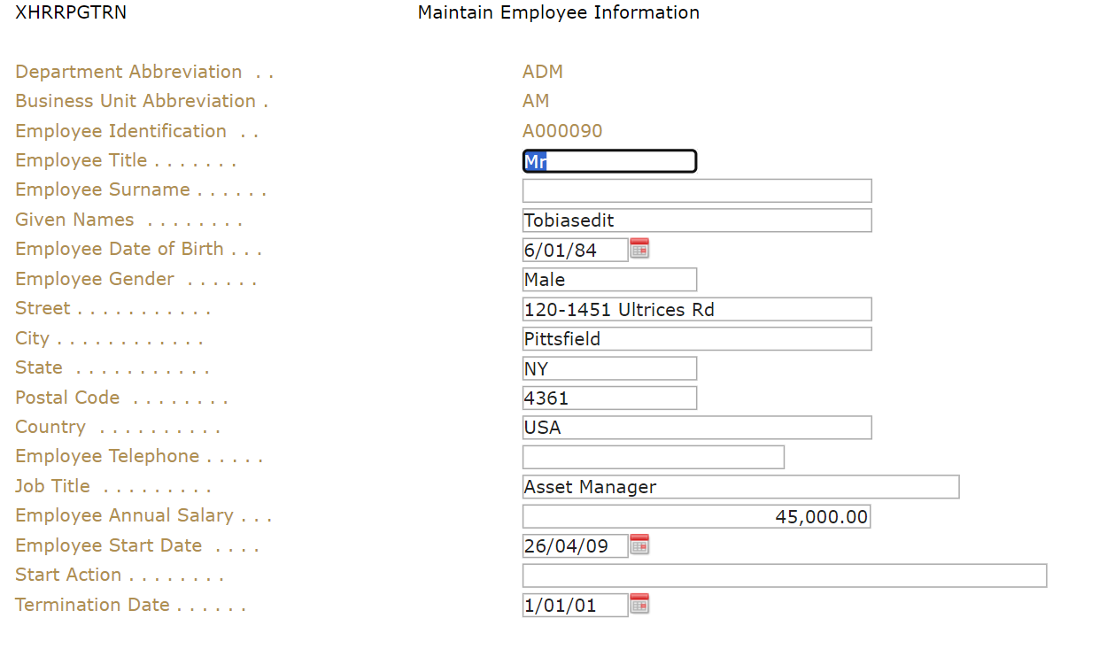

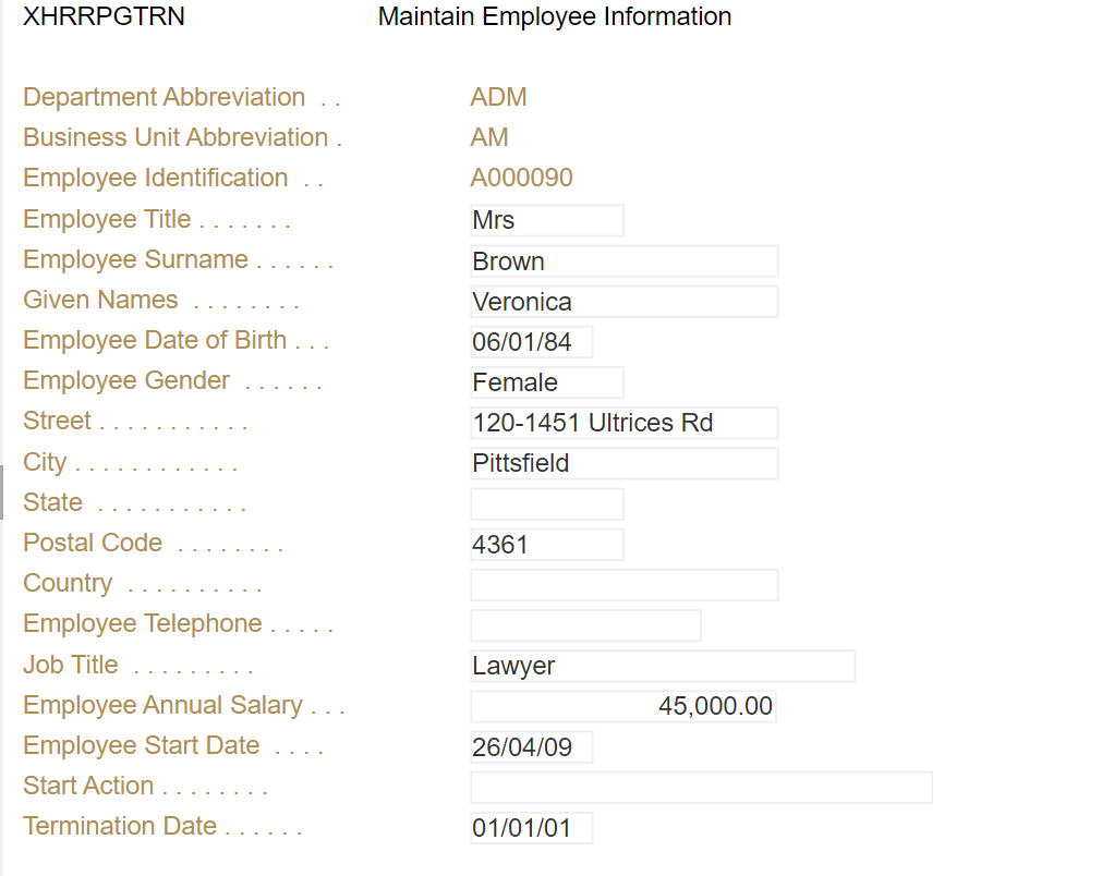

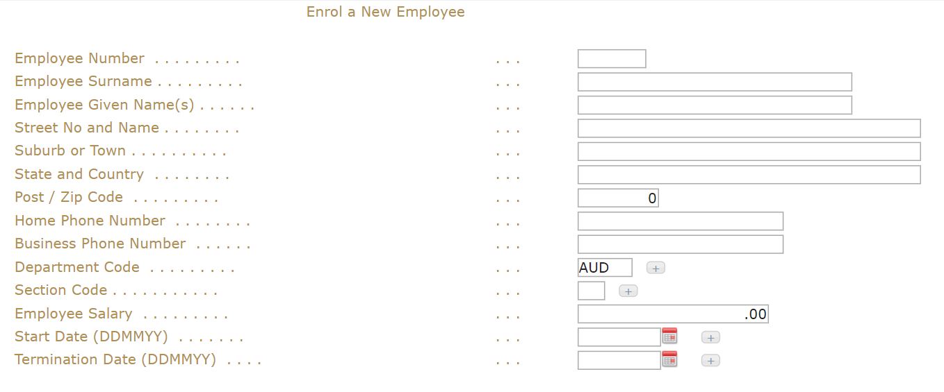

Example – Dynamically refreshing a drop down without server interaction
Start Point
The shipped aXes demonstration screen named XHRRPGTRN_Maint is used.

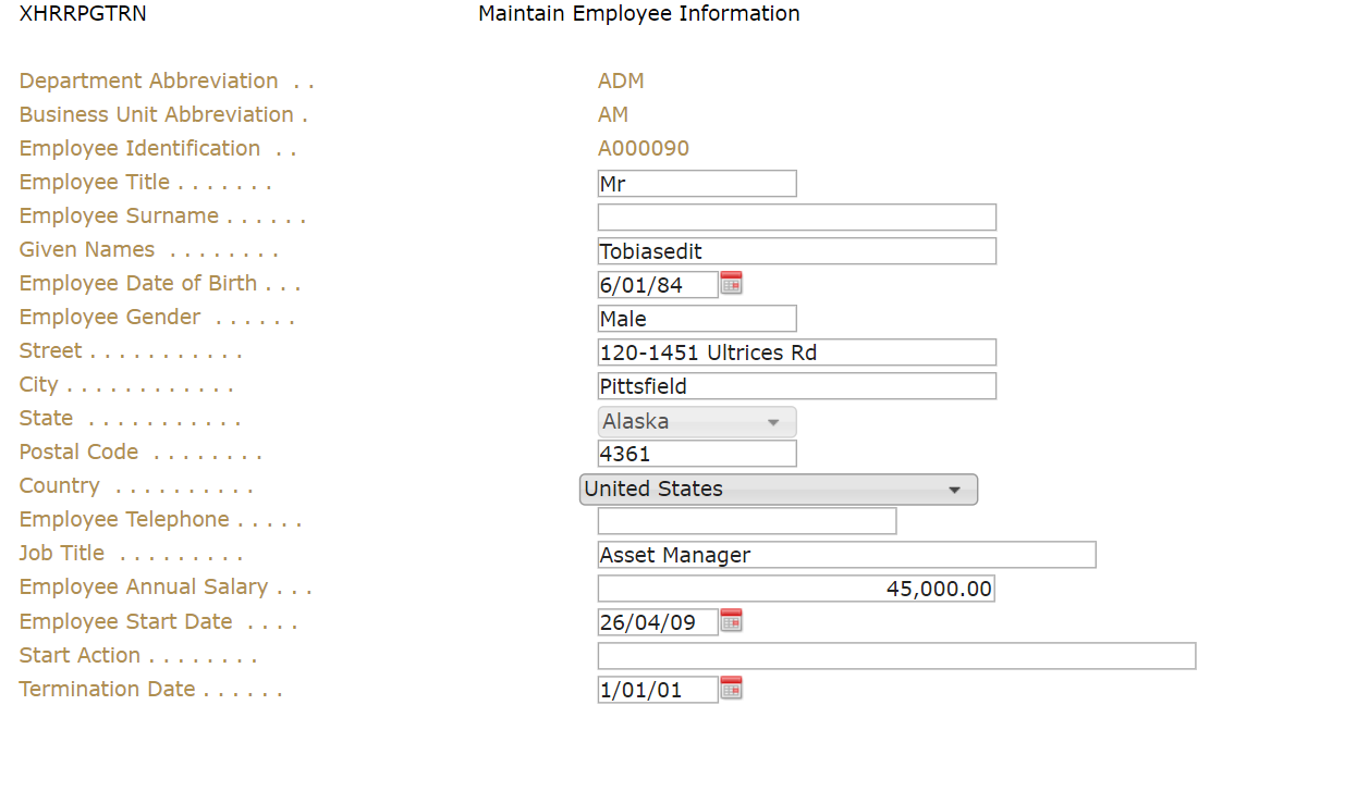

The State field is named Employee_State and the Country field is Employee_Country:
Result
Employee_State and Employee_Country are replaced with drop downs that source its data from static tables. Employee_State is sensitive to the value of Employee_Country so that it will show the states for the selected country without server interaction:
Steps
Edit tables_static.txt and add the following table of US and Australian states:
DefineObjectInstance {
  className = "StaticTable",
  name    = "US_OZ_State",
  source  = "inline",

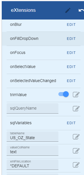

v  Employee_State was selected and changed to be a Drop Down.
v  These properties were then set in the Drop Down eXtension:
dataSourceType:
     Static Table
     tableName:
     US_OZ_State
onFillDropDown (script):
/* Get the current country */
var currentCountry = FIELDS("Employee_Country").getValue();
/* Only add entries to the drop down which match the value of the country field */
if (currentCountry == ROW.countryCode)
   ENV.returnValue = ROW.text;
else
   ENV.returnValue = null;
·               Employee_Country was selected and changed to be a Drop Down
·               These properties were then set in the Drop Down eXtension:
dataSourceType:
     Static Table
     tableName:
     ISOCountry
/* For the purpose of this exercise, filter the countries so that we only add Australia and USA */
var country = ROW.value;
if ( (country == "AUS" ) || (country == "USA" ) )
else
onSelectValueChanged (script):
/* Set the country field value first and then refresh the state drop down. Refreshing the state drop down will cause it to be reloaded from the table data triggering the onFillDropDown event. Because now the country has changed, the state drop down will only fill the states according to the changed value of country */
FIELD.setValue(ROW.value);
FIELDS("Employee_State").refresh();
Remarks:
To avoid the Drop Down overlapping part of the input fields you can set the font size in the Drop Down's style property. For example, you can set it to xx-small:
In this picture we changed the size of the States but not the Country:

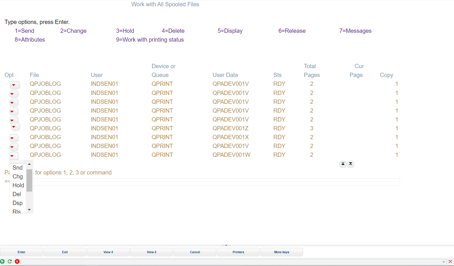

Start Point
A screen like Work With Spool Files:
Result
The option fields are turned into drop-downs to make it simpler to select.
Steps
1) Add this table definition to your tables_static.txt:
      name    = "WrkSplF_Options",
      source  = "inline",
      rows = {
                {value="",text=""},
                {value="1",text="Snd"},
                {value="2",text="Chg"},
                {value="3",text="Hold"},
                {value="4",text="Del"},
                {value="5",text="Dsp"},
                {value="6",text="Rls"},
                {value="7",text="Msgs"},
                {value="8",text="Attr"},
                {value="9",text="Prt Sts"},
2) Repeat this step for each of the Opt fields ONLY IN THE FIRST PAGE of the screen:
v  Make the field a Drop Down and size it appropiately
v  Set the dataSourceType to Static Table and the tableName to WrkSplF_Options
v  Set onSelectValueChanged to
if (ROW.value != "") {FIELD.setValue(ROW.value); SENDKEY("Enter");
3) Save the screen.
You can now use the drop down options to work with a file.

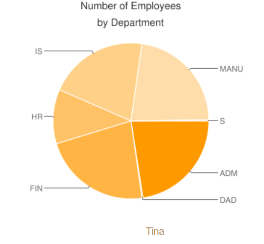

Example – Dynamic Google Chart 1
By using this extension you will be subject to the Google Terms of Service as outlined in http://code.google.com/apis/chart/tems.html
Start Point
You can start with any screen because charts are not associated with fields. For the sake of this example we will start with a blank screen.
Result
A Pie Google Chart showing the number of employees by department. They use data from static tables that were created by direct scripting (instead of being loaded from the server):
Steps
       name               = "XHREmployee",
       source             = "sql",
       selectSQLcommand   = "XHRDEPCDE from AXESDEMO.XHREMPTN order by XHRDEPCDE",
       resultColumnNames  = {"deptCode"},

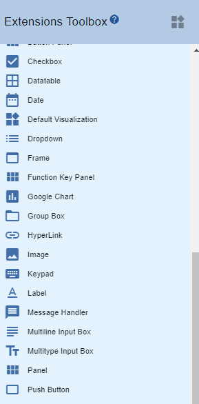

Add a new element, set its extension type as Google Chart and size it.
Now set these extension properties:
tableName: Employees_in_Dept
onLoadChart – intermediate version:
/* Load the static tables file */
TABLEMANAGER.loadStaticTables(USERENV.staticTablesFile);
/* The department table returned by the selectSQL filled with departments */
var deptTable = TABLEMANAGER.getTable("XHREmployee");
/* The table to be filled manually based on the department table */
var chartTable = TABLEMANAGER.getTable("Employees_in_Dept");
/* Get the total number of table rows which is the same as the total number of employee */
var iRows = deptTable.childCount();
var savDept = "";
var iEmployeeInDept = 0;
var oChild;
/* Traverse the static table, count the number of employees for each department and insert a child row into the table nominated in the tableName property whenever a change of department is detected. Note the order by in the selectSQL statement makes sure the records are ordered by the department code */
for (var i = 0; i < iRows; i++)
 oChild = deptTable.child(i);
 if (oChild.deptCode != savDept)
   if (savDept != "")
     chartTable.insertChild({chartData:iEmployeeInDept.toString(),chartLabel:savDept});
   savDept = oChild.deptCode;
   iEmployeeInDept = 1;
 else
    iEmployeeInDept++;
Title: Number+of+Employees|by+Department

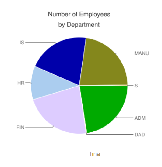

INTERMEDIATE RESULT 1:
To add colors you could add the RGB hex color codes to the colors property. In this case because there are 5 departments you would add 5 color codes like this:
colors: 00AA00,FFCC00,DDCCFF,ABCDEF,0000AA
However, since we don't really know how many departments until the query is executed, the proper way to do it is inside the for loop when the department changes. To do this we need an array of colors to select from, a positional index, a variable to store the entire color string and a variable for the comma separator:
/* array of colors to set to the different departments. It should contain enough colors so that no color is repeated.  */
var arrayColors = ["00AA00", "FFCC00" , "DDCCFF", "ABCDEF", "0000AA", "84871C", "FF9900"];
var iColorIndex = 0;
var chco = "";
var colorSep = "";
Now we modify the logic inside the for loop to start building the color string:
var savDept = "";
var oChild;
   if (savDept != "")
     /* Make sure we are not passed the last color and if we have start from the first one */
     if (iColorIndex >= arrayColors.length)
       iColorIndex = 0;
     chco += colorSep + arrayColors[iColorIndex];
     iColorIndex++;
     /* Change the color separator so from now one it puts a comma before the next color */
     colorSep = ",";
 else
    iEmployeeInDept++;
Then we must set the colors property:
FIELD.setProperty("colors", chco);
The entire script should now look something like this:
var savDept = "";
var oChild;
var chco = "";
var colorSep = "";
    if (savDept != "")
        iColorIndex = 0;
      iColorIndex++;
      colorSep = ",";
   else
     iEmployeeInDept++;

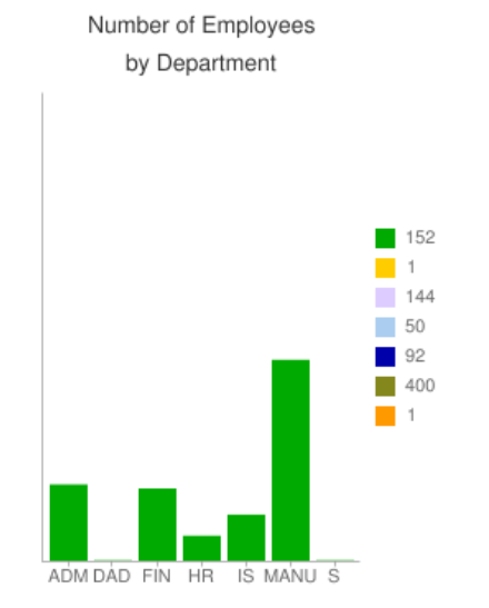

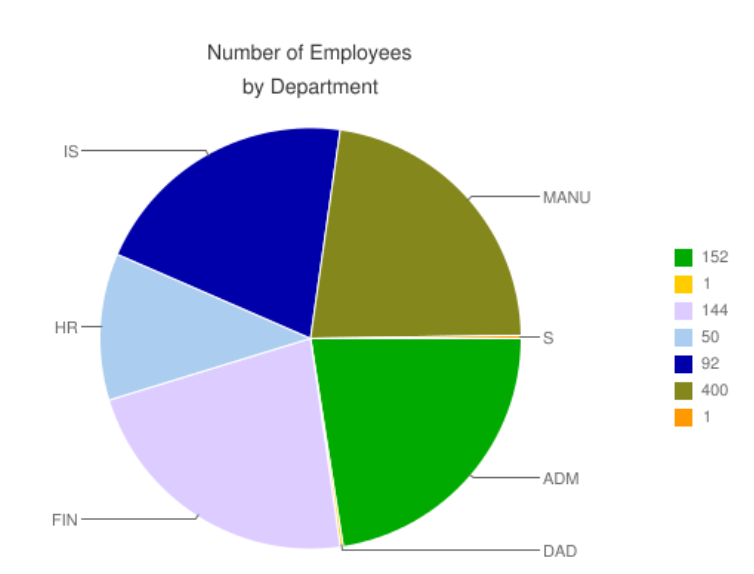

FINAL RESULT:
To visualize the PIE chart as a BAR one, change the type property from p to bvs:
The chart should now look something like this:
The colors are all the same because for this type of chart, the character used to separate the colors inside the color string (chco=) is a pipe char instead of a comma.
In the onLoadChart script modify this line
colorSep = ",";
To this line
colorSep = "|";

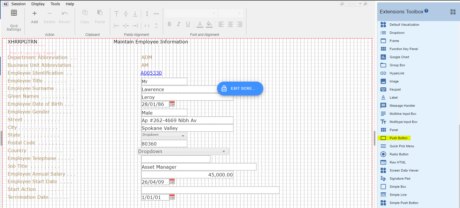

Example – Creating Static Tables by Scripting
Start Point

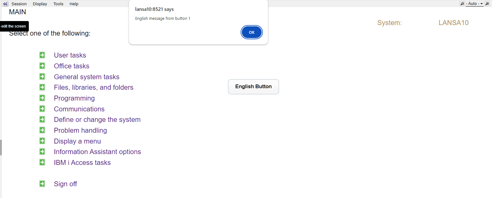

The IBM i Main Menu, identified as screen MAIN, with the entry field named CommandLine:
Result
A dropdown and a push button are added to the MAIN screen. They use data from static tables that were created by direct scripting (instead of being loaded from the server):
Steps
v  Select Application from Extendable objects, application properties are viewed.
v  These properties were then set in the application's Basic properties:
onApplicationStart
var t1 = TABLEMANAGER.getTable("TestTable1");
t1.insertChild({text:"Copy File",value:"CPYF"});
t1.insertChild({text:"Call Program",value:"CALL"});
t1.insertChild({text:"This Job",value:"WRKJOB"});
t1.insertChild({text:"System Status",value:"WRKSYSSTS"});
var t2 = TABLEMANAGER.getTable("TestTable2");
var iLimit = t2.childCount();
var sMessage = "";
for (var i = 0; i < iLimit; i++)
   var row = t2.child(i);
   sMessage += row.code + " - " + row.desc + "\r";
window.alert(sMessage);
Since many 5250 applications are heavily depending on the cursor for its navigation, a mechanism to control the position the cursor in the back-end 5250 program is required.
Supposing that you have an enrol employee screen, and the department field has a prompt function that displays the list of available departments.
When the prompt function is executed on the Department Code field, a screen showing the department list will appear:
To select a department in a 5250 terminal, the user will have to position the cursor on the correct line to select a department. However this will not work for a web-based application, so we need to programmatically instruct the program on the back-end to move the cursor to a specific location when the user clicks on a department in order to let the program know which department is selected.
The steps below show one way to do this.
Switch the caption property of the hyperlink to scripting mode by clicking on the pencil icon.
Type the following script into the script editor:
FIELD.getValue()
This instructs the hyperlink to display the original 5250 text as the link’s text.
Then type in the following script in the onClick event of the hyperlink:
FIELD.set5250Cursor();
SENDKEY("Enter");
FIELD.set5250Cursor method will move the logical cursor to the element that is clicked. It then simulates an ENTER keystroke.

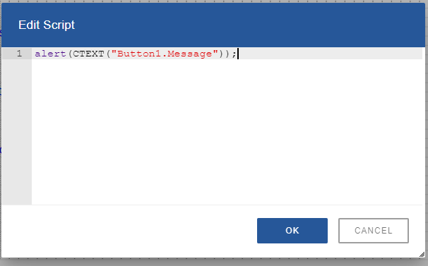

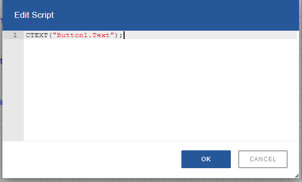

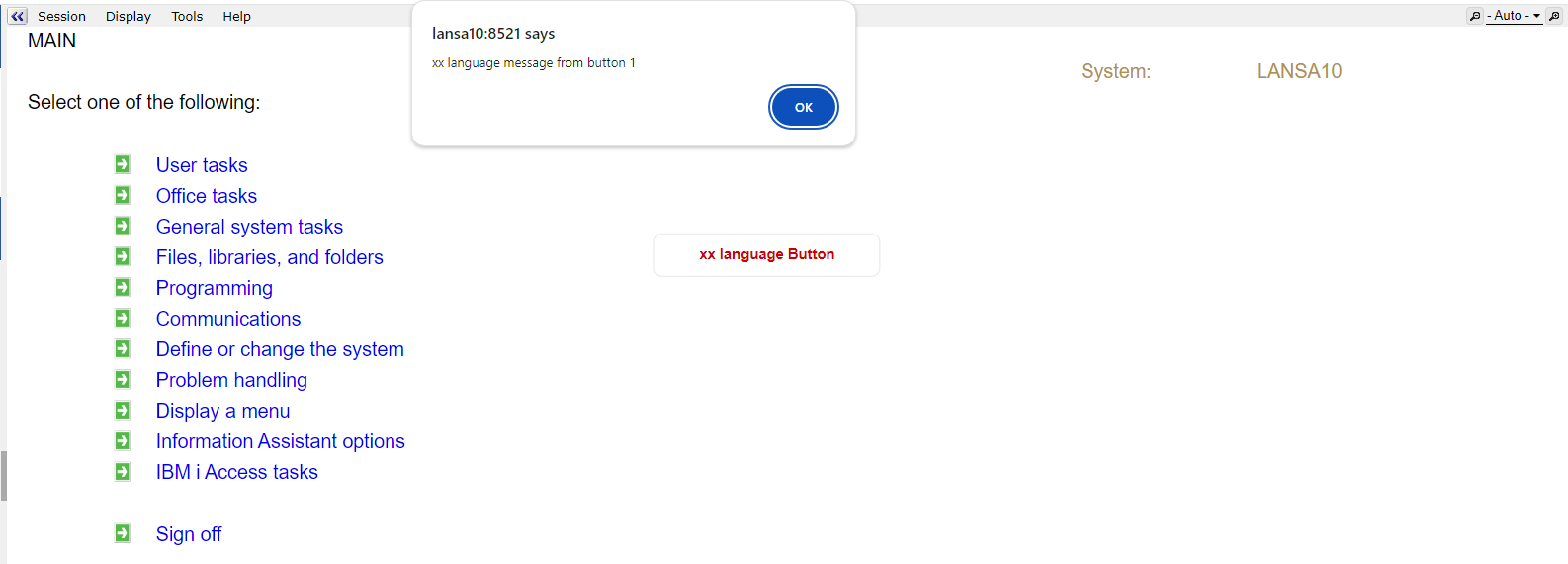

Example – Multi-lingual Text
Start Point
The System i Main Menu, identified as screen MAIN, with the entry field named CommandLine:
Result
A push button is added to the MAIN screen. When axes is run in the default language or with &lang=en added to the url, the button caption and the alert issued by clicking the button use english captions.
When &lang=xx is added to the url, the xx language caption is shown for the button and in the alert:
Steps
v  Drag and drop pushbutton from panel of axes screen to the Design area.
v  Set its properties as shown:
(note that the caption property is a script, not a value)
v  Edit the file in axes/ts/lang called Custs_Text_en.txt
Add the following entries just before the last line:
"Button1.Text" : "English Button",
"Button1.Message" : "English message from button 1",
v  Create a new file in axes/ts/lang called Custs_Text_xx.txt (Copy it from  Custs_Text_en.txt)
Edit it and modify the entries you added in the previous step to be:
"Button1.Text" : "xx language Button",
"Button1.Message" : "xx language message from button 1",
v  From a command line on the iSeries, check  the authority to the file, using wrklnk 'axes/ts/lang/*', and then option 9 against the entry for Custs_Text_xx.txt.
Ensure that the authority for *PUBLIC is *R (and only *R).
v  Ensure all your changes are saved, and restart axes in run mode, and sign on.
On the main screen, the button should show the english caption: English Button
And when the button is clicked, the alert should show:  "English message from button 1"
v  Restart axes in run mode, but add &lang=xx to the url
On the main screen, the button should show the xx language caption: xx language Button
And when the button is clicked, the alert should show:  "xx language message from button 1"
Example – Visibility control (over a screen element - dynamic)
Start Point
Result
A push button is added to the MAIN screen. When the button is clicked it makes the screen title element ("System i Main Menu") disappear.
Steps

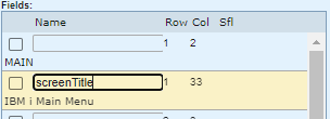

v  Start axes in developer mode, and go to the first screen.
v  Click on the "System i Main Menu" element on the screen. (The screen title element)
v  Name the element "screenTitle". (Now that the element is named, it can be referenced by other elements on the screen) Save your changes.
v  Click on the Edit Screen button and Add a User Field
v  Set the new element's visualization to push button
v  Set the push button's caption property to:
Make title invisible
v  Set the onClick property to:
var TitleField = FIELDS("screenTitle");
TitleField.setProperty("visible", false);
TitleField.refresh();
v  Save your changes. You should now be able to click the button and make the screen title disappear
Observations
In the onClick code:
is allowing the button element to work with the screen title element, by accessing the FIELDS collection, using the name "screenTitle" as the key.
All elements have a visible property, so set the screen title's visible property to false, using this method.
When you change a property of an element that changes its appearance, you usually need to tell the element to re-draw itself. This is done with the .refresh() method.
Example – Using a date format not available in the Date eXtension
Start Point
The Maintain Employee Information subfile identified as screen XHRRPGTRN_Select.
Result
Date of Birth displaying in format YY/MM/DD not available in the list of extension formats:
Steps
v  Edit the language defaults file /ts/lang/Texts_Cust_xx.txt where xx is the language code.
v  Find the dateFormatDisplay setting. Change the shipped default from:
"dateFormatDisplay" : "d/mm/yy",
to
"dateFormatDisplay" : "y/mm/dd",
v  Save and close the file.
v  Clear your browser cache to pick up the new file version.
v  Start axes in developer mode go to the Maintain Employee screen, and edit the screen.
v  Select one of the date fields in the subfile and change it to use the Date eXtension.
v  Save the screen. YY/MM/DD is now your language default dateFormatDisplay.
v  Likewise, if most of your programs use YY/MM/DD to store dates but DD/MM/YY to display them, leave the dateFormatDisplay with its shipped default value and change the dateFormatServer value.

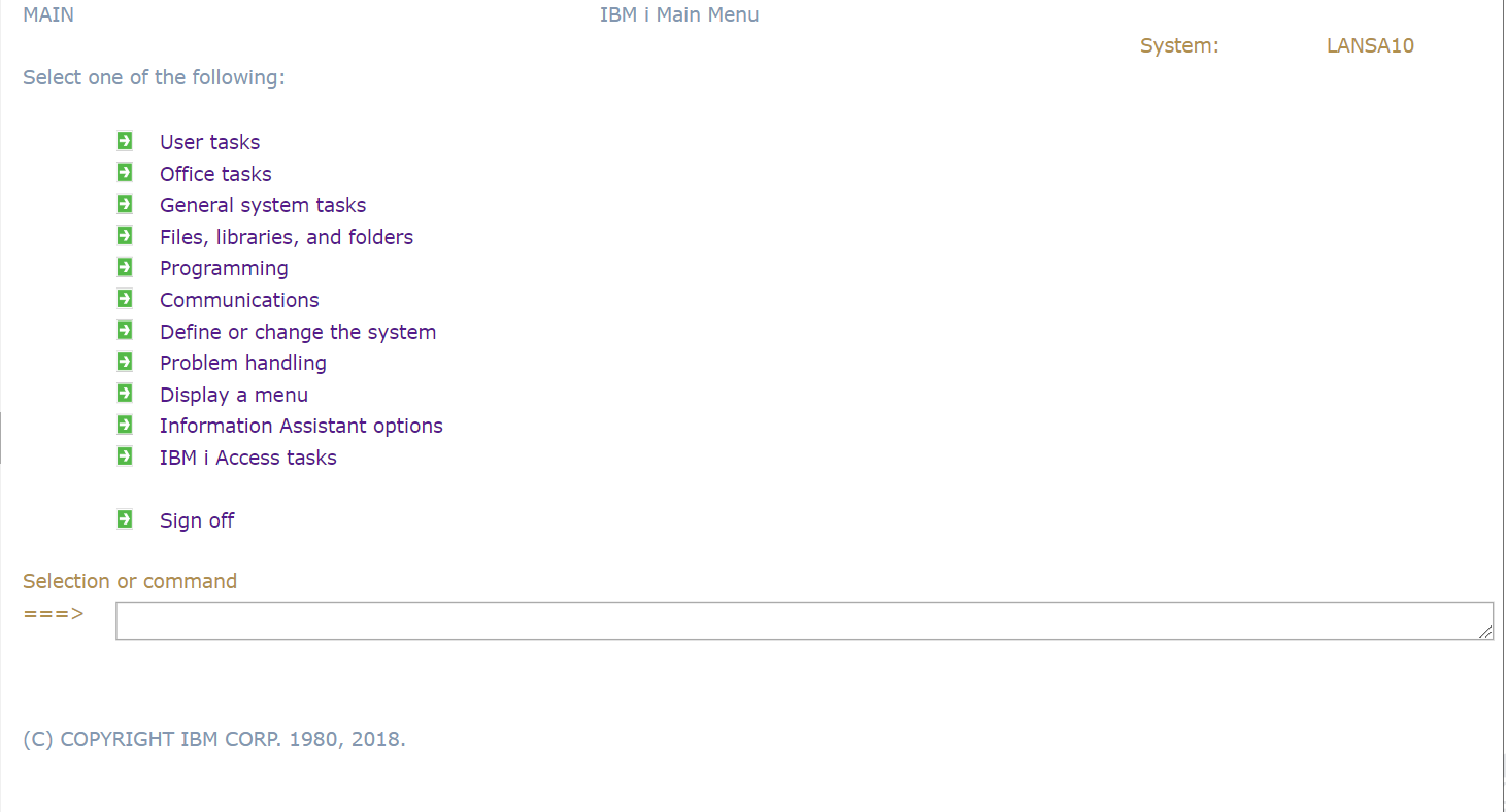

Example – Visibility control over a new element - dynamic
Start Point
Result
Two push buttons are added to the MAIN screen. When the second button is clicked it makes the first button disappear.
Steps
v  Start axes in developer mode, and go to the first screen, and edit the screen.
v  Drag and drop push button from panel of axes screen to the Design area.
Make its caption property "Button1"
Make its name property "Button1" (this allows other elements on the screen to set its properties)
Make its caption property "Make Button1 invisible"
Make its onClick property:
var Button1 = FIELDS("Button1");
Button1.setProperty("visible", false);
Button1.refresh();
v  Save your changes. You should now be able to click the second button and make the first button disappear

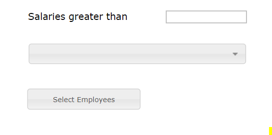

Example – Dynamic Tables using a condition that evaluates a numeric value
Choose any screen and add:
1. A New Element type Label. Set its caption to "Salaries greater than"
2. A New Element. Leave it with the Default Visualization. Set its name to Request_Salary
3. A New Element type DropDown. Set its name to Employees
Set its onSelectValue to ROW.firstName.
Set its dataSourceType to Dynamic.
Set its onFillDropDown property to: ROW.lastName + " (" + ROW.salary + ")";
Set its SQL Query Name to EmployeeSalaries
Set its SQL Variables property to:
var salaryValue = parseFloat(FIELDS("Request_Salary").getValue());
if ( (isNaN(salaryValue)) || ( typeof(salaryValue) != "number") )
  ENV.SQL.SQLVariableSalary = 0;
else
  ENV.SQL.SQLVariableSalary = salaryValue;
4. A New Element type Push Button:
Set its caption to Select Employees
Set its onClick property to FIELDS("Employees").refresh();
The screen with the New Elements should look something like this:
