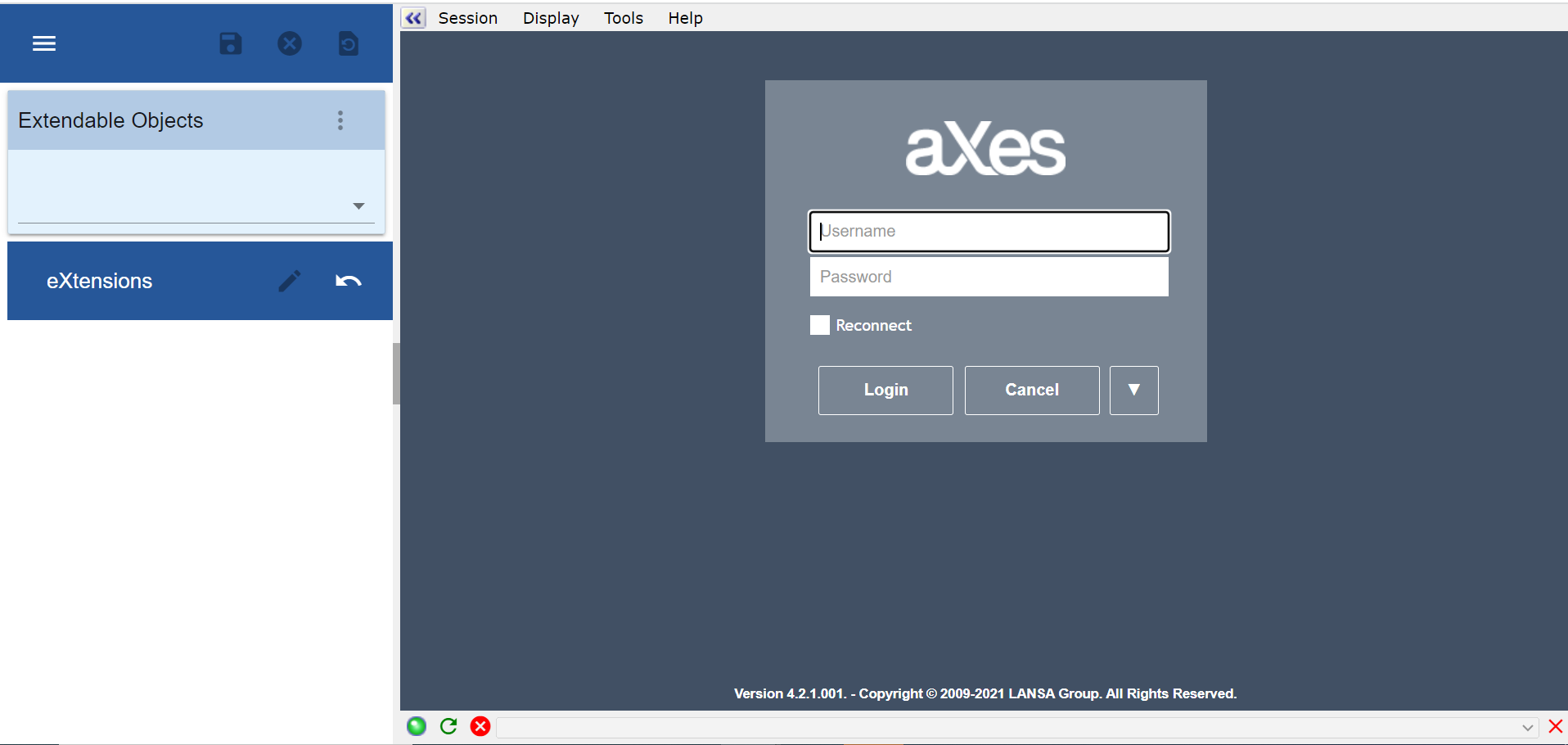

Use your desktop shortcut to open the aXes Home Page.
Click on the Developer tool link in the top bar.

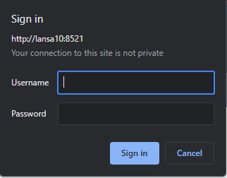

When requested, enter the aXes developer username and password.
The shipped defaults are,
User Name: dev
Password: dev
You should change these default values.

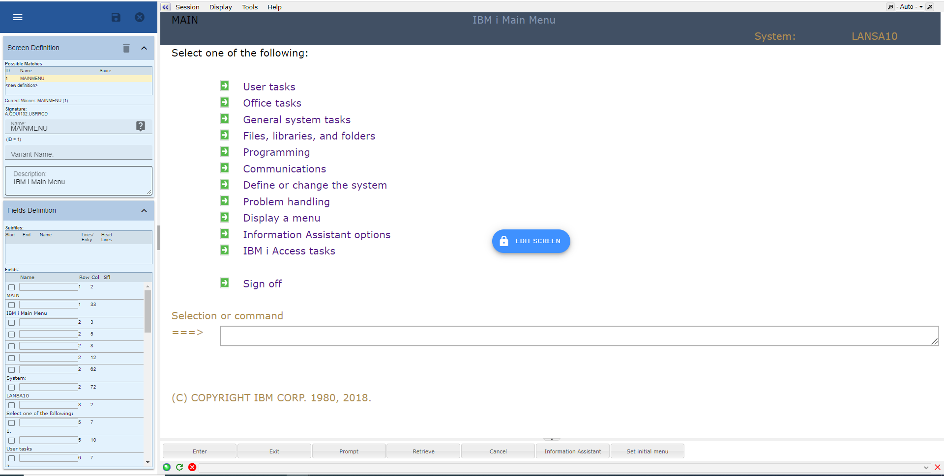

You are now going to identify the Main Menu screen and assign a name to the field on the screen where commands are typed in.
First, click the Suggest button (the one with a question mark) on the Screens tab - aXes will examine the screen and suggest a name and a description. If you are happy with the name suggested click on the save icon at the top of the page.
Next, lock the screen for design by using the Edit Screen button. Always lock the screen for design before customizing it.
Change the screen Name to MAINMENU.
Naming Conventions
Choose names for screens and screen elements like you would name a variable in a programming language.
Use only letters of the English alphabet, the numbers 0 to 9 and _ (underscore).
Do not use imbedded blanks in names.
Names are case sensitive.
Then, click on the screen title on the 5250 screen to select it (e.g. IBM i Main Menu, System i Main Menu or i5/OS Main Menu). This should highlight the field in the Screens tab on the left.
Check the box beside the field.
Change the screen Description to IBM i Main Menu.
Click the Save button to save the definition of the screen you have called MAINMENU.
To check that aXes now identifies the MAINMENU screen correctly, display a different 5250 screen by entering the IBM i command WRKJOB.
You should see the Possible Matches list on the Screens tab change to say <new definition> indicating that the Work Job screen currently has no name.
Return to the main menu and you should see the Possible Matches list change to indicate that this screen name is MAINMENU.

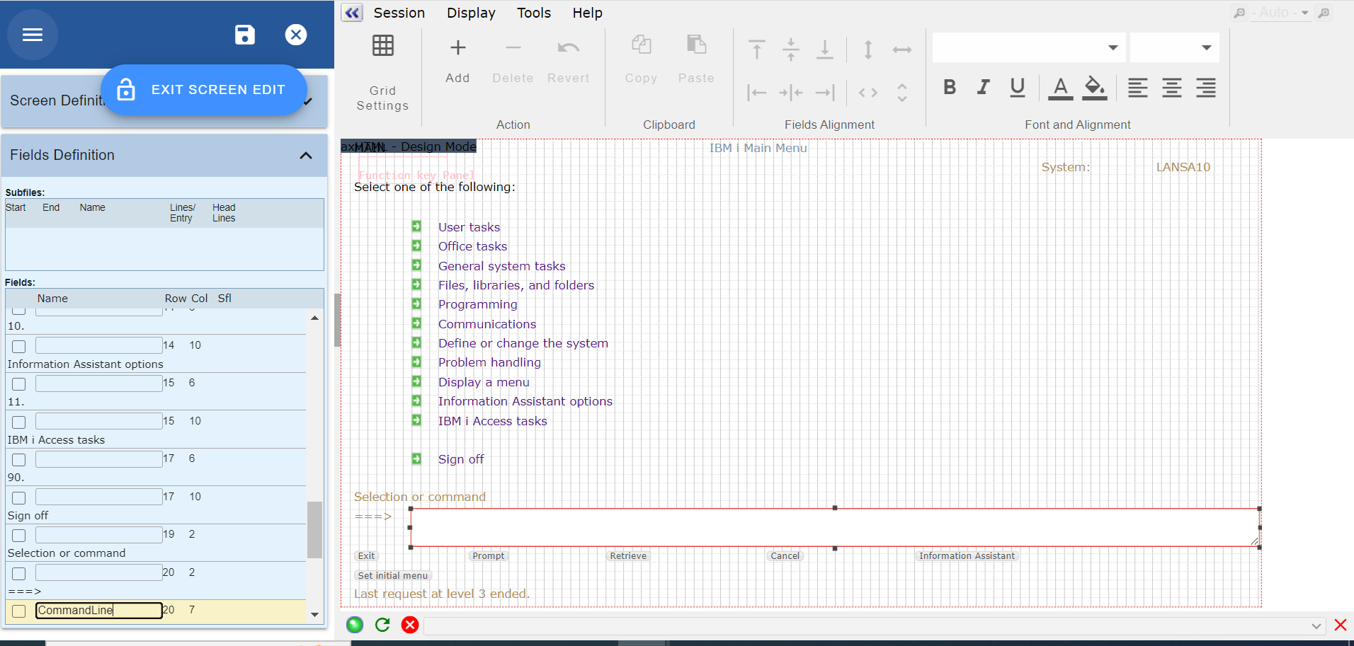

With the MAINMENU screen displayed, select the field where commands are entered by clicking on it. This should automatically select the field on the Screens tab and scroll down to it.
Type in the name CommandLine for the field.
Your Screens tab should now look like this:
Click the Save button again to (re)save the definition of the screen called MAINMENU.

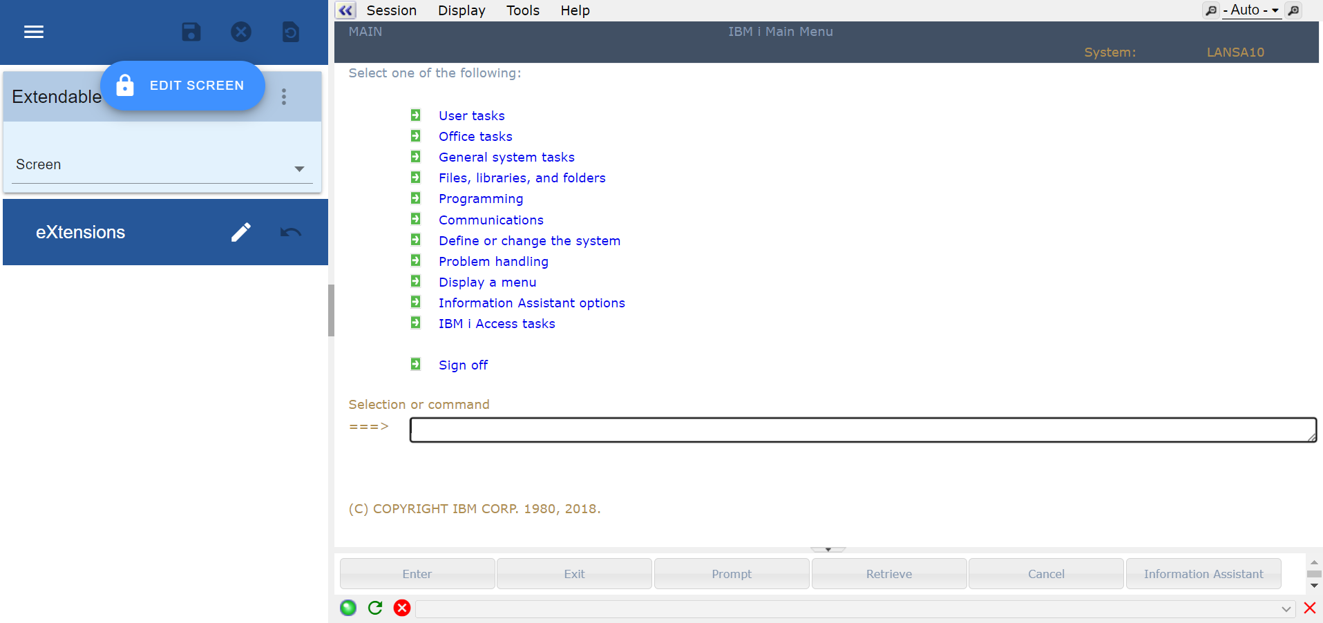

Click on the button Exit Screen Edit to preview your screen.

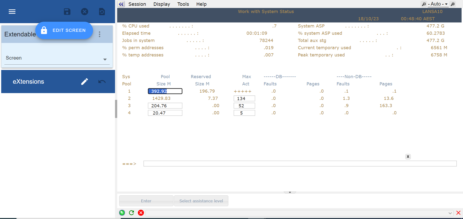

The Output Field Dilemma
When a field is not really a field - it's just a bit of output text
Usually, output fields are correctly recognized as starting at the beginning of the field. This means that when named, they continue to be recognized, no matter what value they contain.
But in one special case, when the record format does not define the fields, (as in for example the "fields" on the WRKSYSSTS screen), aXes works out the field start position based on the field contents. For right-adjusted numeric fields, this means that when the screen is redisplayed with a value with more digits, the start position of the "field" changes, and since aXes identifies fields by their start position, it does not recognize the text as belonging to the same field.
You should be aware of this special case when naming fields:

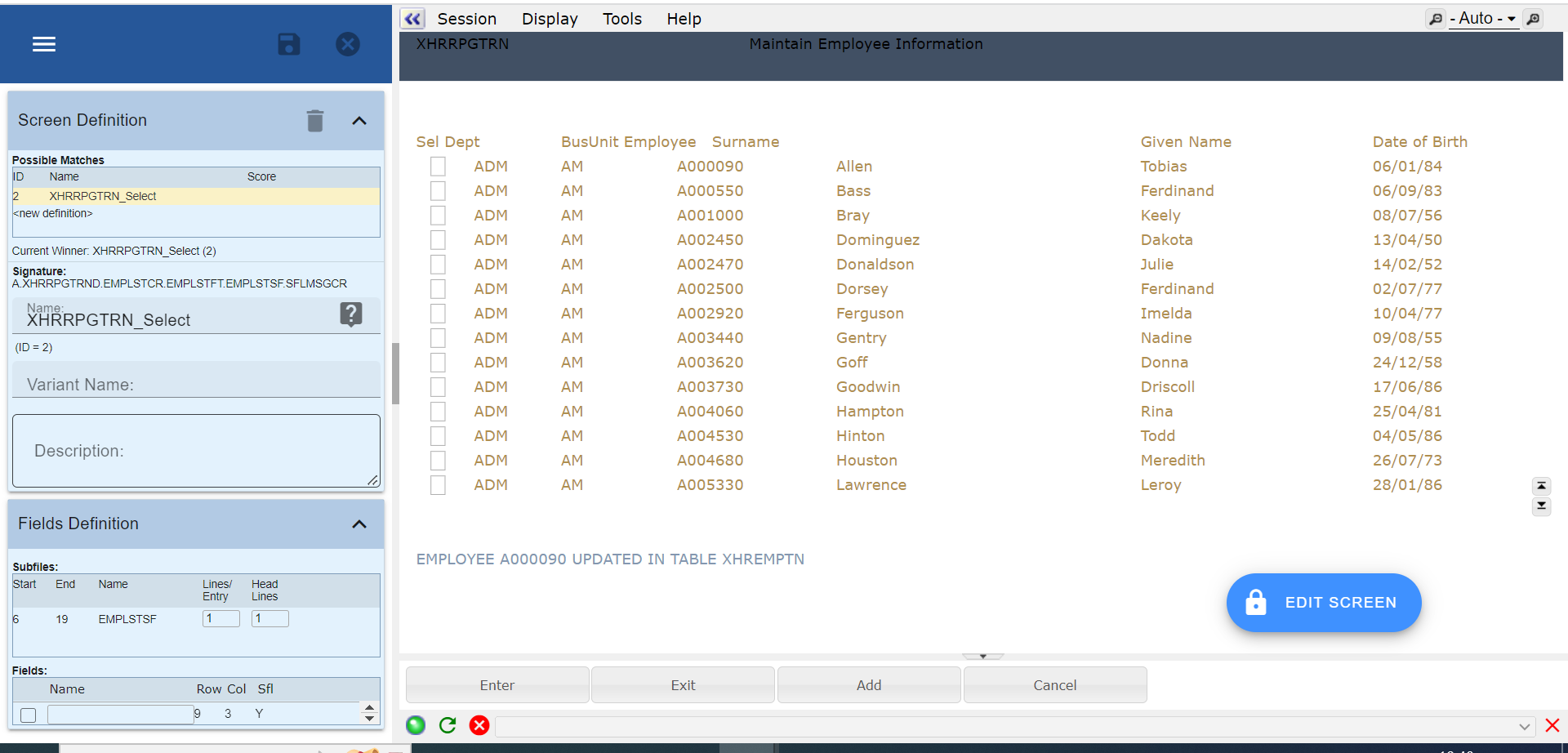

Next, enter an X beside an employee and press the Enter key to display the employee information.

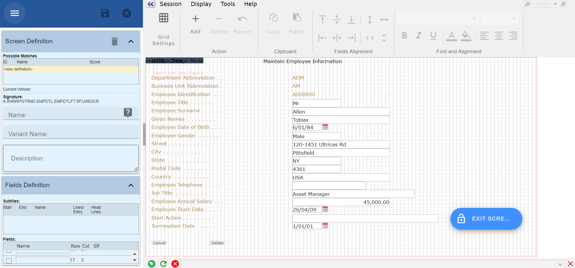

The resulting 5250 screen should look something like this:
Check that your Screens tab says this is a new (unnamed) 5250 screen.
On the Screens tab, click the Suggest button.
Change the suggested screen name to XHRRPGTRN_Maint
Click the Save button.
You have now assigned the name XHRRPGTRN_Maint to this particular 5250 screen.
