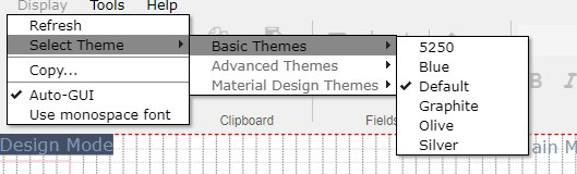

aXes ships with a set of basic 5250 themes. These are accessible from the aXes menu:

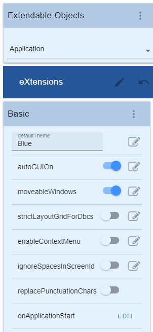

Next the basic application property defaultTheme is set to indicate the default theme is blue:
Note that the default theme is a property that can be derived from script - so you can change the defaultTheme at application start-up.

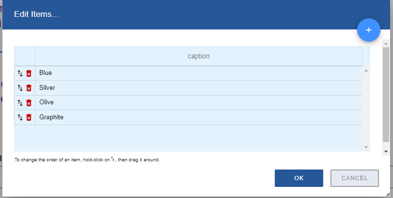

In this example a quick pick menu extension has been added to the IBM i Main Menu, add items list like this:
Save the changes and exit from edit mode. On hover will see a screen like:
