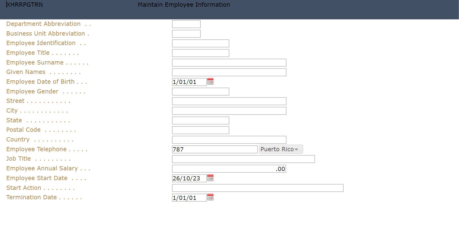

In this exercise you will modify the Maintain Employee screen for adding a new employee. The screen was identified in Tutorial 2 as XHRRPGTRN_Maint.
You will add a drop-down next to the Employee Telephone field which will display US regions corresponding to telephone area codes. The values in the drop-down are sourced from a static table you will create.
(Whether the screen on your system looks like the following screen shot depends on which other tutorials you have completed.)
When the end-user selects a region, the area code is added to the Employee Telephone field.

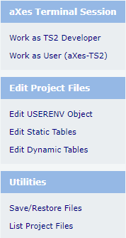

In the Projects Home Page choose the option Edit Static Tables:
Insert a new line and copy/paste this code and then save the file:

Save the extension, then exit from the screen to the XHRRPGTRN_Select screen and click the Add button to add a new employee.
In the XHRRPGTRN_Maintain screen use the Region drop-down to set the area code in the Employee Telephone field.

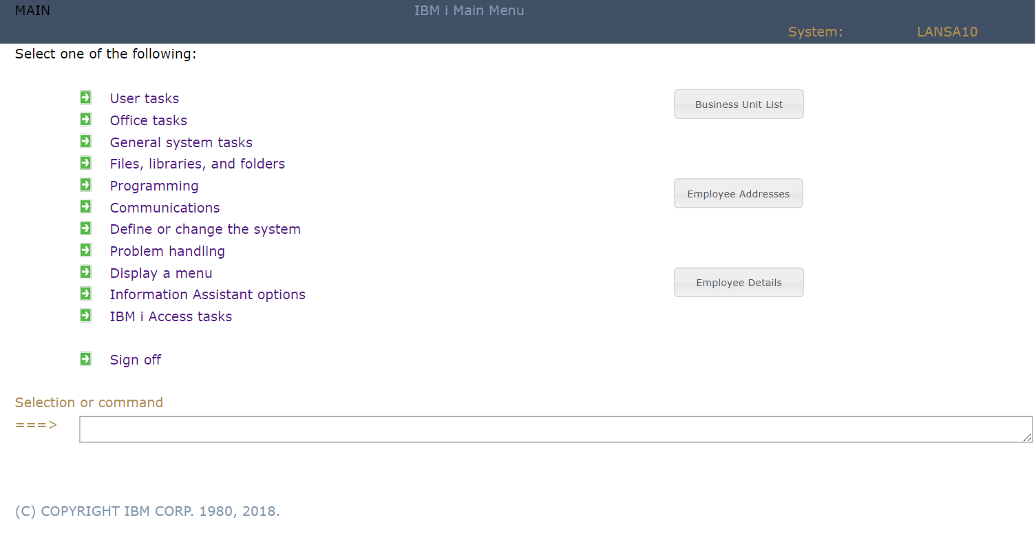

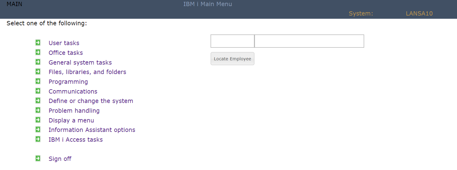

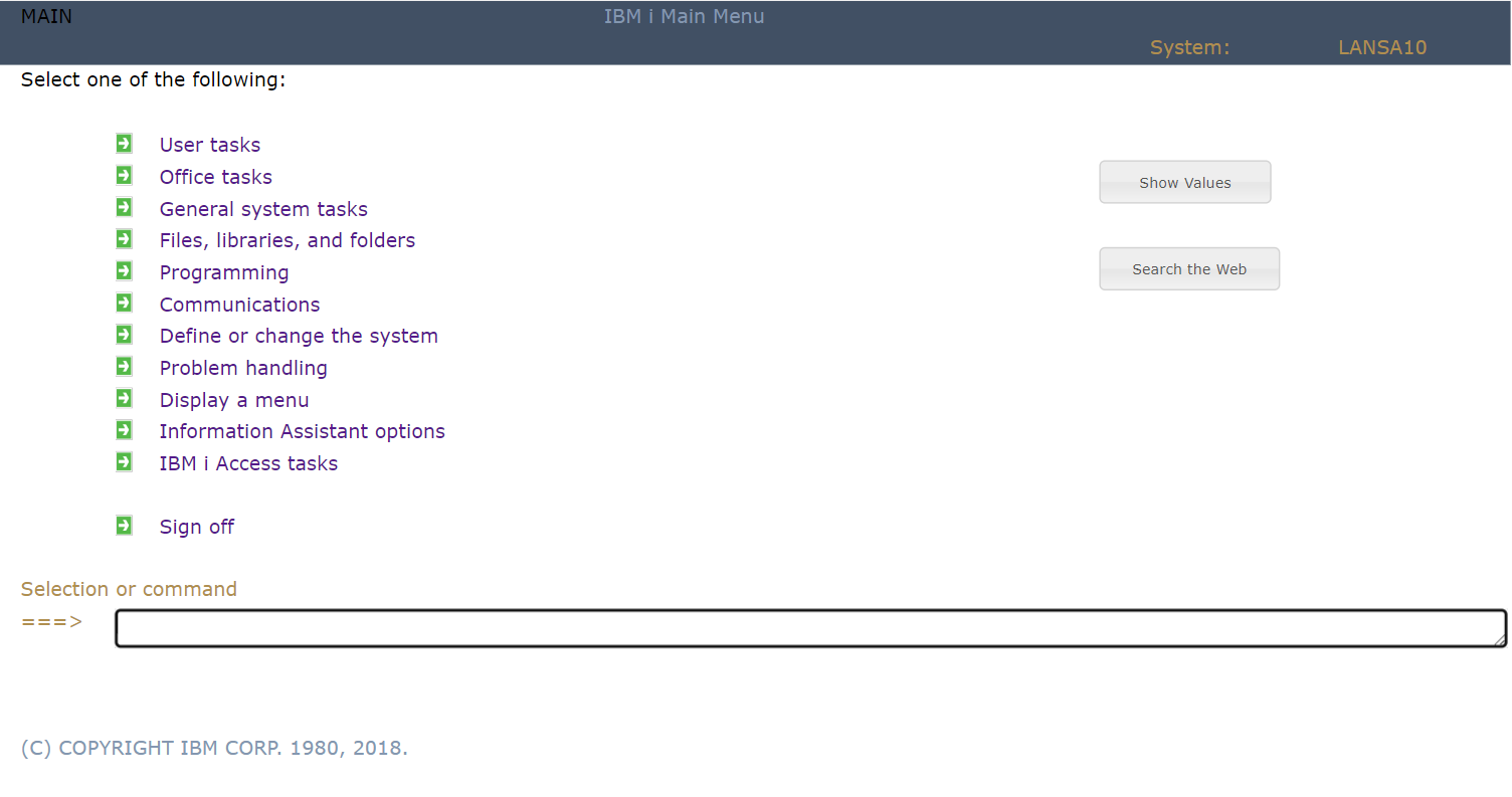

Now, alter the System i Main menu so that it can support employee inquiries, for example like this:
DT_01
To do this add 3 new elements to the 5250 screen.

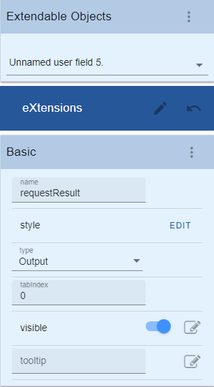

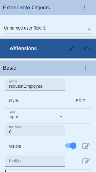

The first is a Default Visualization input field named requestEmployee:
The second is an output result field named requestResult, with a 1px solid red border:
And the last is a push button with caption Locate Employee:

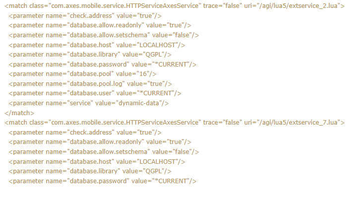

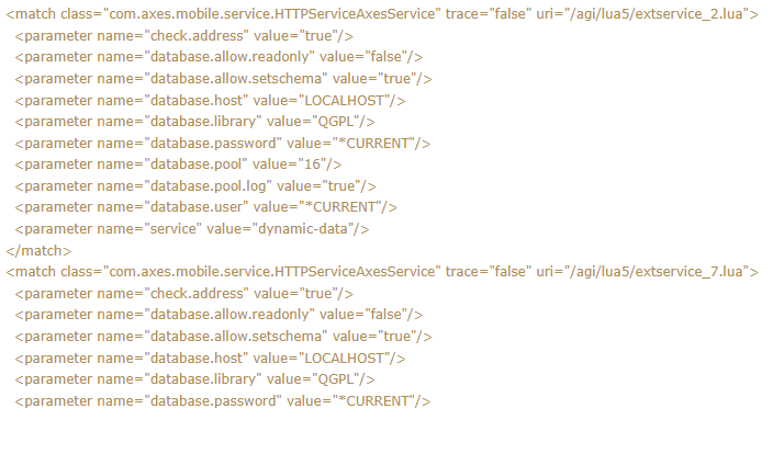

In addition, enable the sql query R/W and the setSchema option on the config file:
In the /jsm/instance/system/httpd.xml file, set the database.allow.readonly option to "false" and the database.allow.setschema option to "true".
Before changing (Default value):
After changing (setSchema ON):

Go to the screen identified in Tutorial 2 as XHRRPGTRN_Maint
In XHRRPGTRN_Maint identify the field Job Title as Job_Title
Step 3.
Double-click the Job_Title field to open the Add eXtension window then select DropDown  from the list and click the Add button.
Step 4.
Set these Drop Down properties:
dataSourceType: XML file
tableName: JobTitles
onFillDropDown: ROW.title
xmlFileName: JobTitles_en.xml
onSelectValue: ROW.title
onSelectedValueChanged: FIELD.setValue(ROW.title)
Note that the value *DEFAULT for xmlFileLocation means either /ts/screens/<definition set> if there is a definition set specified in the URL, otherwise, it means
Save the screen and test the drop-down.

Open the Projects Home Page. Select your project and then use the Edit Static Tables option.
Add this new static table into your application:

Now add a push button like this to the IBM i Main menu:
For the onClick property use this scripting:
/* Load all static tables, in case they are not already been loaded */
/* If they are already loaded this request will just be ignored     */
TABLEMANAGER.loadStaticTables(USERENV.staticTablesFile);
/* Now get a reference to the "MySystemInfo" static table defined on the server */
/* Then put a reference to row/child 0 directly into the USERENV object         */
USERENV.systemInfo = TABLEMANAGER.getTable("MySystemInfo").child(0);
if (USERENV.systemInfo == null)
  window.alert("MySystemInfo row could not be read");
else
  var sMessage = "";
  sMessage += "Company = " + USERENV.systemInfo.companyName + "\r";
  sMessage += "Website = " + USERENV.systemInfo.companyWebSite + "\r";
  sMessage += "Version = " + USERENV.systemInfo.productVersion + "\r";
  sMessage += "Language = " + USERENV.systemInfo.defaultLanguage + "\r";
  sMessage += "Library = " + USERENV.systemInfo.defaultOS400Library + "\r";
  window.alert(sMessage);
/* USERENV.systemInfo is now a real script object, so other scripts can */
/* now just access USERENV.systemInfo.companyWebSite (say) directly     */
Save your screen changes.
You may have already loaded the static tables, so to be sure, close and restart your aXes development session.
Redisplay the IBM i Main Menu and click the Test Static Table Access button.

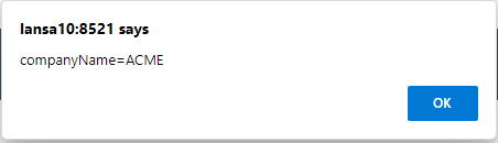

You should see a message box like this:
This example demonstrates how a static table may be used to provide useful control information scripts.

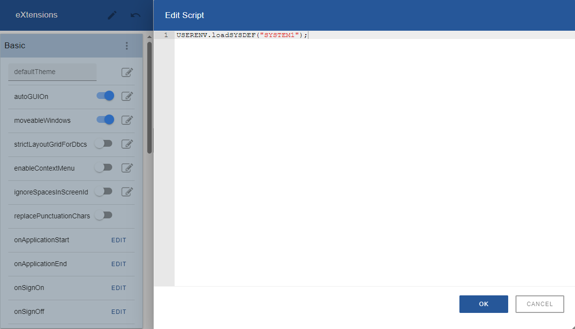

Step 3 – Read database table MYSYSDEF when the user logs on

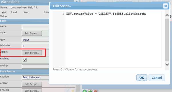

Put this function into your project's USERENV.JS file - as part of your USERENV object:
   /* Load the system definition from MYSYSDEF file for the system name specified */
   loadSYSDEF : function(sysname)
      /* Load the SQL table build by reading table MYSYSDEF for the specified system name. The  */
      AXES.TableManager.loadDynamicTable("MYSYSDEF",USERENV.dynamicTablesFile,{SQLVariable_System:sysname}, false);
      var oTable = AXES.TableManager.getTable("MYSYSDEF");
      var oChild = oTable.child(0);
      /* Handle not found */
      if (oChild == null)
         USERENV.SYSDEF = {}; /* Create default empty USERENV.SYSDEF object */
         window.alert("USRENV.loadSYSDEF: MYSYSDEF load failed. No data available for system named " + sysname );
      /* Attempt to convert JSON data in USERENV.SYSDEF java script object */

Now edit your project so that at application sign on it executes the new USERENV.loadSYSDEF("SYSTEM1"); function in the onSignOn event, like this:
Save your changes.

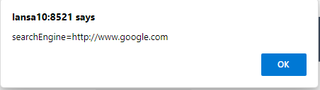

Name the IBM i main system menu and add two push button eXtensions.
The first, titled Show Values should do this in its onClick event:
window.alert("companyname=" + USERENV.SYSDEF.companyName);
window.alert("allowSearch=" + USERENV.SYSDEF.allowSearch.toString());
window.alert("searchEngine=" + USERENV.SYSDEF.searchEngine);
The second, titled Search the Web should do this in its onClick event:
window.open(USERENV.SYSDEF.searchEngine,"_blank");
Additionally, the Search the Web button should have its visibility conditioned by altering the visible property to execute this script:
  ENV.returnValue = USERENV.SYSDEF.allowSearch;
Like this :
Save your changes and start a new user 5250 session.
Click the Show Values button. You should see 3 message boxes like this:
Click the Search the Web button.
You should see a new web page open up with the Google search engine displayed.
Now - update the SYSTEM1 row in the MYSYSDEF data base table so that the field JSONDATA contains this data:
    companyName : "Wigets", allowSearch : true, searchEngine : "http://www.bing.com"
being careful with case, colons, quotes and commas.
Start a new user session so that the updated MYSYSDEF data is loaded at log on.
When you click the Search Values button you should see the company name Widgets and the search engine URL as Microsoft's Bing.
When you click the Search the Web button you should see the Microsoft Bing search engine instead of the Google engine displayed.

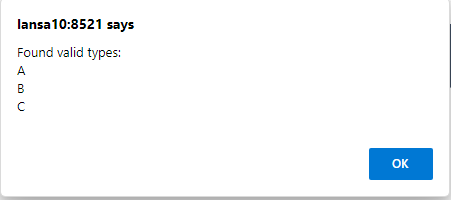

In an eXtension script activated by a push button execute this script:
var SYSDEF = USERENV.SYSDEF;
var message = "Found valid types :";
for (var index in SYSDEF.validTypes)
  message += "\r" + SYSDEF.validTypes[index]; /* Insert value preceded by a CR */
window.alert(message);
When the script is executed you should see:

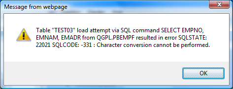

However, when the static tables are being loaded this error is displayed:
This error is indicating that data in the file connot be converted to the code page being used by the aXes server.

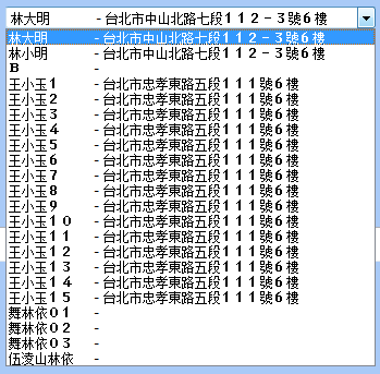

The EMPNAM and EMPADR values can now be used in a drop down eXtension, like this example displaying ROW.text + “ – “ + ROW.address:

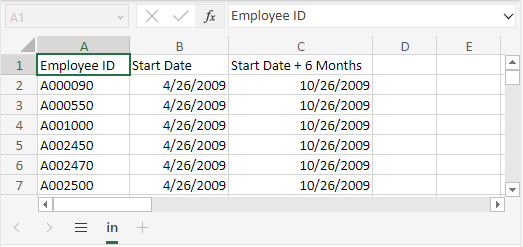

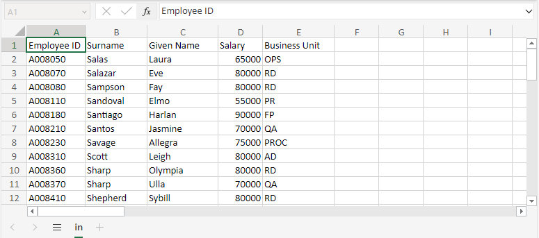

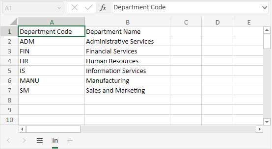

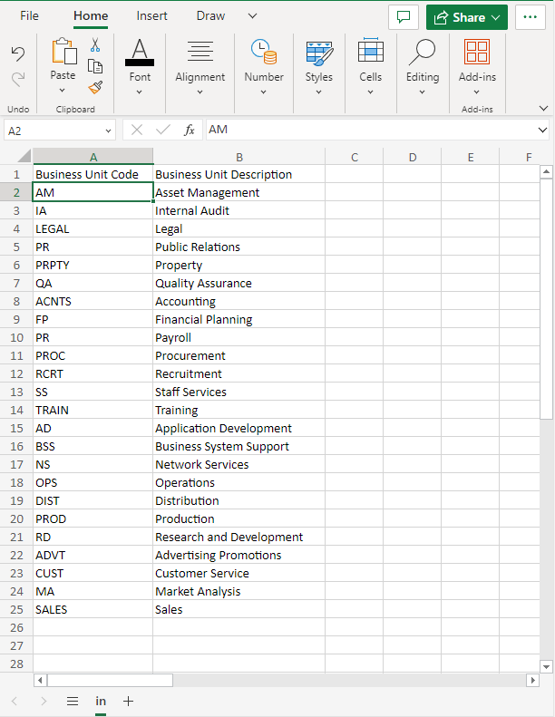

Using Dynamic Tables to Produce Spreadsheets and Reports
You can use Dynamic table definitions to produce spreadsheet data. This offers a convenient way to download data to a user’s PC. Once the data is in a spreadsheet the user can format it, save it, and print it as they like.
Dynamic tables have to be defined by a professional software developer so only approved and content audited downloads can be executed.
Note: Generic downloading tools may present some security and/or data content misinterpretation risks (eg: end users including deleted orders into quarterly sales revenue reports).
In this tutorial three dynamic SQL requests are added to the dynamic tables definition file. Use the aXes Projects Home page Edit Dynamic Tables option:
Then add these three definitions named Example1, Example2 and Example3:
    DefineObjectInstance {
      className          = "DynamicTable",
      name               = "Example1",
      source             = "sql",
      selectSQLcommand   = "XHRBUABRV, XHRBUSUNT from AXESDEMO.XHRBU",

Next three buttons elements are added to the System I Main Menu:
Note: The Selection or command entry field is named CommandLine in this example.
The three new buttons are then given this onClick scripting:
Business Unit List Button
var result = TABLEMANAGER.convertDynamicTable("Example1",USERENV.dynamicTablesFile);
if (result.error == false)
   var URL = document.location.protocol + "//" + document.location.host + "/ts/" + result.outputFileName;
   window.open(URL,"_blank");
Employee Address Details Button
var result = TABLEMANAGER.convertDynamicTable("Example2",USERENV.dynamicTablesFile);
Employee Details Button
var empid = FIELDS("CommandLine").getValue();
var requestdetails = { orientation:"V", SQLVariable_EmployeeId:empid };
var result = TABLEMANAGER.convertDynamicTable("Example3",USERENV.dynamicTablesFile,requestdetails);
   if (result.outputLineCount == 0)
      window.alert("Employee with number " + empid + " not found. Is the number and the case of the number correct?");
   else
When the Business Unit List Button is clicked the SQL command named Example1 is executed. The output is sent to a CSV file. The name of the file produced is returned in result.outputFileName. The output file is then opened in a new browser window.
So the user should see:
And when they click Open button they should see:
From MS-Excel they can save the file to their hard drive, reformat the content, display graphs and pivot tables, print the content, etc, etc.

If we want to output the result to a MS excel spreadsheet, we first create a dynamic table containing the SQL statement, like this (remembering to remove the initial "select"):
      name               = "SQLExample01",
      source             = "sql",
      selectSQLcommand   = " XHRDEPCDE, XHRDEPNME FROM AXESDEMO.XHRDEPT",
      resultColumnCaptions = { "Department Code", "Department Name" },
Then we create an Axes button that makes use of the dynamic table, with  onClick script as follows:
var result = TABLEMANAGER.convertDynamicTable("SQLExample01",USERENV.dynamicTablesFile);
When the button is clicked, it should produce a simple list of departments in a spreadsheet, like this:

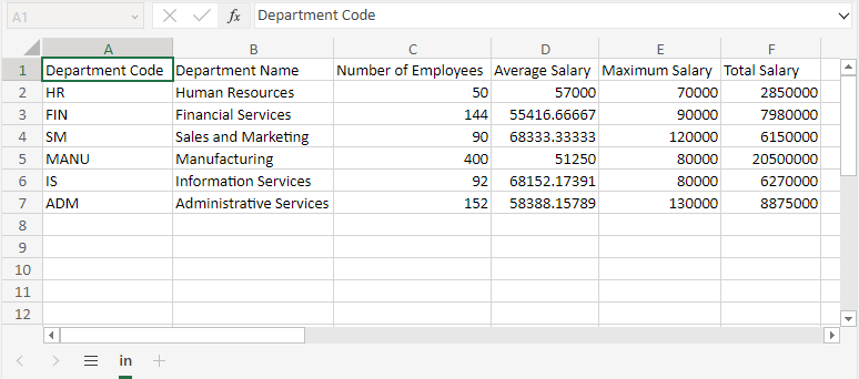

we create a dynamic table containing the SQL statement, like this:
      name               = "SQLExample03",
      source             = "sql",
      selectSQLcommand   =
      [[ de.XHRDEPCDE, MAX(XHRDEPNME), COUNT(*), AVG(XHRSALARY), MAX(XHRSALARY), SUM(XHRSALARY)
      FROM AXESDEMO.XHRDEPT de, AXESDEMO.XHREMPTN em
      where de.XHRDEPCDE = em.XHRDEPCDE
      GROUP BY de.XHRDEPCDE
      resultColumnCaptions = { "Department Code", "Department Name", "Number of Employees", "Average Salary", "Maximum Salary", "Total Salary" },
Save your table, and modify the onClick routine of the Axes button to point to "SQLExample03"
If you now click the button you should see:

      resultColumnCaptions = { "Employee ID", "Surname", "Given Name", "Salary", "Business Unit" },
Save your table, and modify the onClick routine of the Axes button to point to "SQLExample04"
If you now click the button you should see something like:

SELECT XHREMPID, XHRSTDTE,
DATE(XHRSTDTE) + 6 MONTHS
FROM AXESDEMO/XHREMPTN
      name               = "SQLExample06",
      source             = "sql",
      selectSQLcommand   =
          XHREMPID, XHRSTDTE,
         FROM AXESDEMO.XHREMPTN
      resultColumnCaptions = { "Employee ID", "Start Date", "Start Date + 6 Months"  },
Save your table, and modify the onClick routine of the Axes button to point to "SQLExample06"
