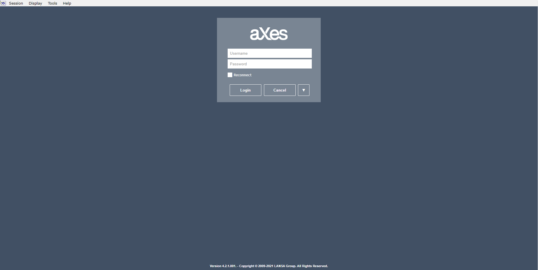

Test your desktop shortcut. The result should look like this (ie: exactly like this shipped log on):

Starting Point – The Shipped Logon Screen

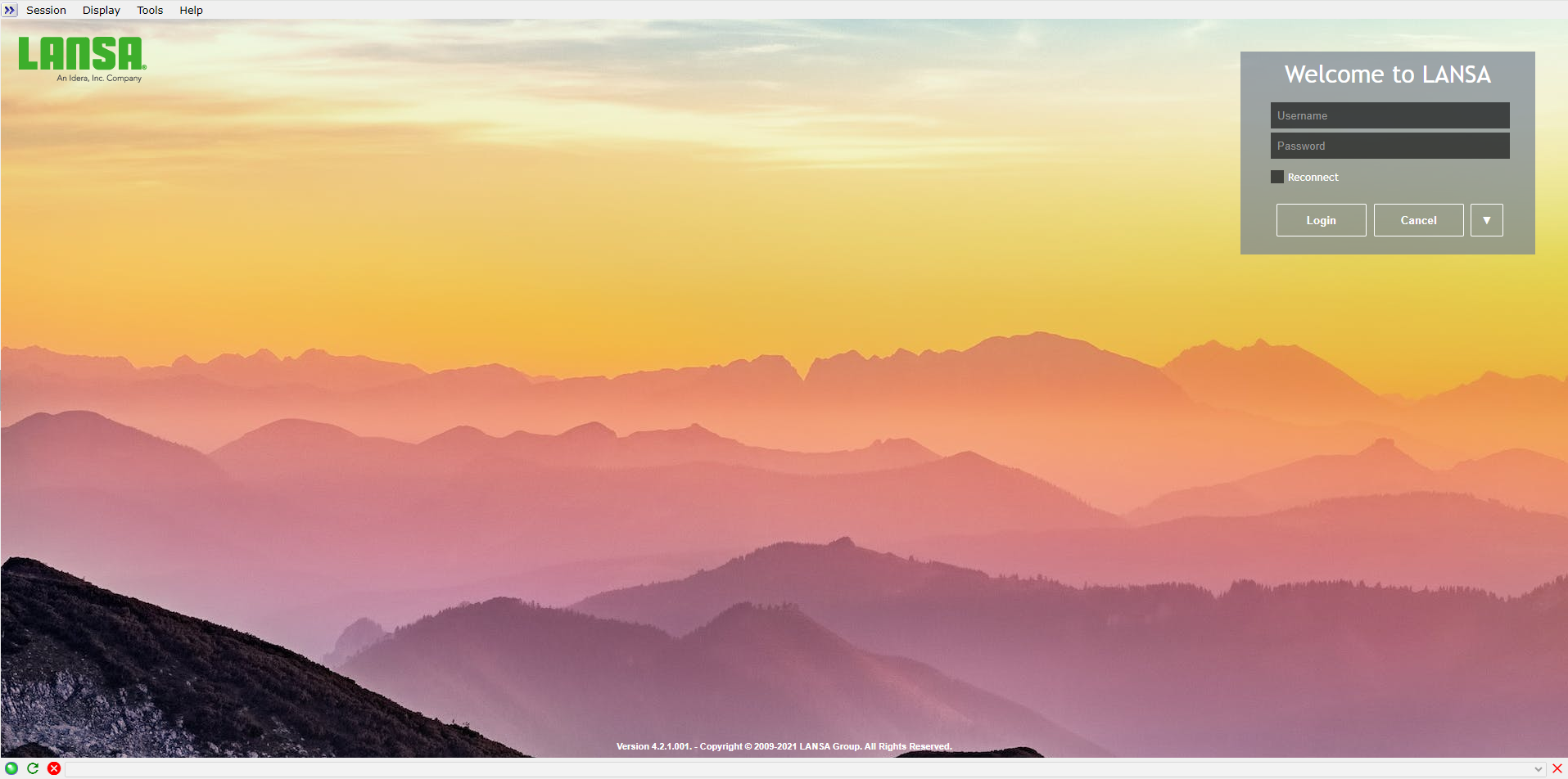

Change The Background Images
In this tutorial, we will use a background image for the whole login page, replace the logo with text and create a new div for the logo with some text, then change the login box’s elements color and opacity to adapt to the background-image.
The background image used is downloaded from Silhouette Of Mountains · Free Stock Photo (pexels.com).
Name this image as “loginBg.jpg” and put it in ts2\css\images folder.
Change the html as follows:
<div id="loginPage">
<div id="logoArea">
    <div id="newLogo"></div>
</div>
<div id="loginFieldsWrapper">
    <div id="loginLogo">
        <div id="centerLogo">Welcome to LANSA</div>
    </div>
Look at the <script> section in MyTest_Login.html and comment out the following line:
</script>
//$("#centerLogo").css("background-image", "url(css/images/centerlogo.png)");
</script>
Add the style entries as follows:
#loginPage {
    width:100%;
    height: 100%;
    position: relative;
    top: 0px;
    left: 0px;
    /*background-color: #415064;*/
    font-family: "Trebuchet MS",Tahoma,Verdana,Arial,sans-serif;
    font-size: 10pt;
    overflow: auto;
    display: table;
    background: url(css/images/loginBg.jpg) no-repeat center center;
#newLogo {
    background: url('http://www.lansa.com/img/lansa-logo.png') no-repeat center center;
    width: 200px;
    height: 100px;
    float: left;
#centerLogo {
    /*background: transparent no-repeat center center;*/
    width: 300px;
    height: 50px;
    margin-left: auto;
    margin-right: auto;
    color: white;
    text-align: center;
    font-size: 30px;
Save your changes, clear your browser cache and reload the page. The result should be like this:

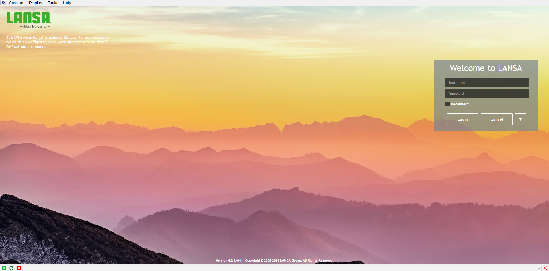

Changing the Login Detail Box
We will change the login box background color so that the background image can still be seen underneath it.
To position the login box to the right and change the opacity of the background color:
#loginFieldsWrapper {
    padding: 10px;
    width: 340px;
    /*margin-left: auto;
    margin-right: auto;
    display: block;
    overflow: hidden;*/
    margin-top: 40px;
    /*background-color: #798593;*/
    background-color: rgba(121, 133, 147, 0.7);
    float: right;
    margin-right: 40px;
#loginLogo {
    /*display: block;
    height: 95px;*/
To change the background and text color of  Reconnect checkbox:
#loginPage input[type='checkbox'] + label:before {
    content: "\00a0";
    background: rgba(0,0,0,0.6);
    color: white;
    height: 16px;
    width: 16px;
    display: inline-block;
    margin-right: 5px;
    padding: 0;
    vertical-align: top;
    margin-left: 2px;
#loginPage input[type="checkbox"]:checked + label:before {
  content: "\2713";
  text-align: center;
  color: white;
To change the background  and its opacity and text color of input and select boxes:
#loginPage input, #loginPage select {
    margin: 2px;
    background-color: rgba(0,0,0,0.6);
    color: white;
To change the color of the button when hovered:
#loginPage .btnFields:hover,
#loginPage .btnFields:active {
    background-color: #f9cb69;
    border-color: #f9cb69;
    -webkit-appearance: none;
    -moz-appearance: none;
To change the background color of the select box on different media:
@media screen and (max-device-width: 600px) {
    #loginPage #advancedLoginFields select {
        height: 36px;
@media screen and (min-device-width: 601px) {
    #centerLogo {
        background-image:none;
        height: 36px;
To not display the background image in mobile and other short screen, add the following:
    body.mobile #logoArea {
       display: none;
    body.mobile #loginLogo {
        /* height: 10px;*/
#loginPage.shortScreen #logoArea {
       display: none;

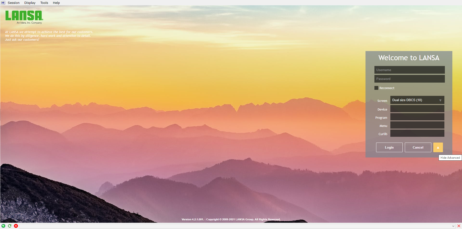

Add a custom text under the logo
Insert these new  lines to add a custom text in the logo area:
<div id="logoArea">
    <br /><br />
    <div id="customText">At LANSA we attempt to achieve the best for our customers.<br />
        We do this by diligence, hard work and attention to detail.<br />
        Just ask our customers!
    </div>
Add the following declaration to MyTest_Login.css:
#customText {
    margin-top: 70px;
    margin-left: 20px;
    color: white;
    font-style: italic;
Click the arrow button to expand the login details and hover the mouse on the button:
