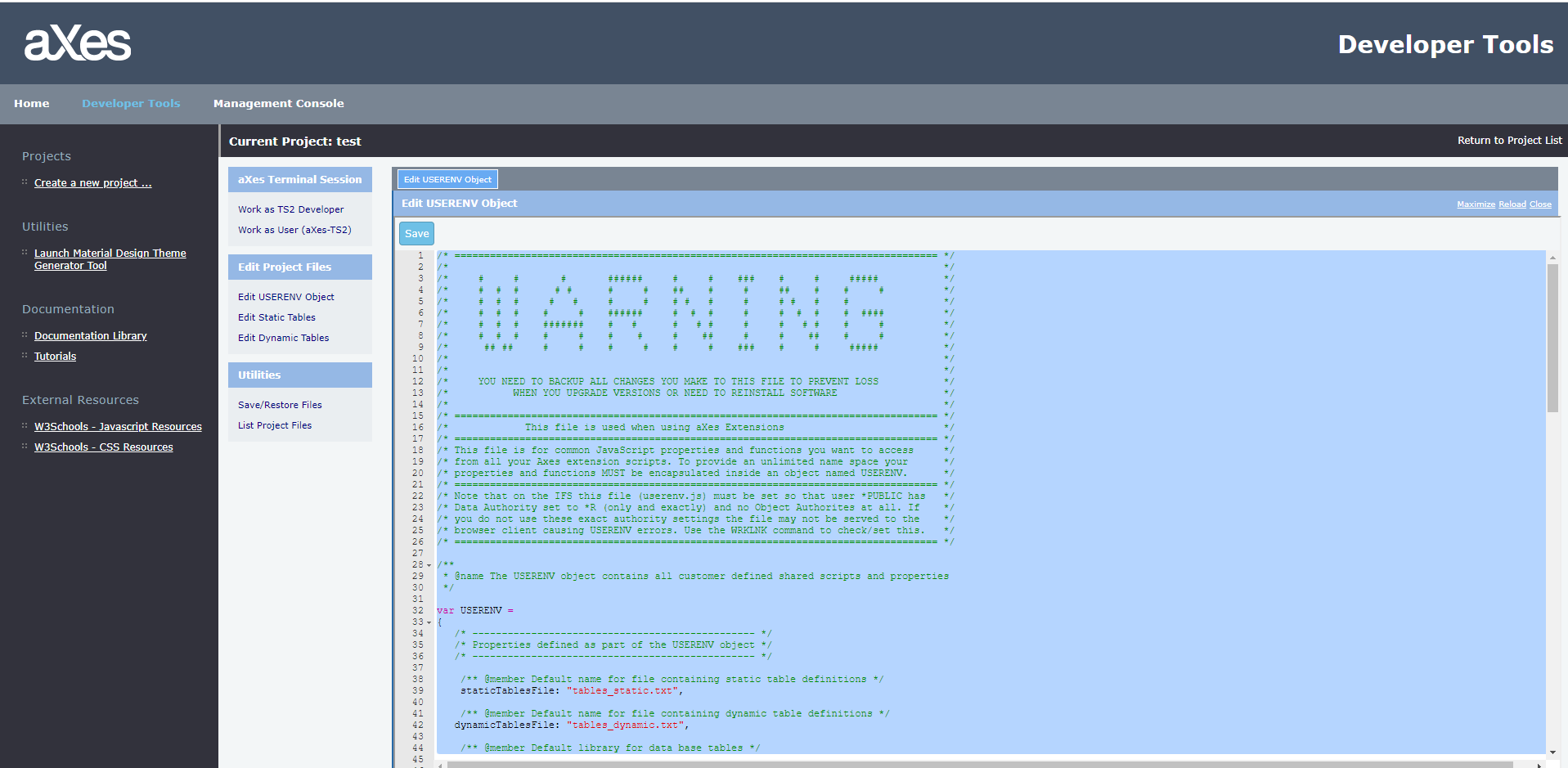

Open the Projects Home Page. Select your project and then use the Edit USERENV Object option. The resulting NOTEPAD display should look something like this:
The warning is very important.
When customizing this file, make sure you keep versions to avoid loss of your work when upgrading aXes or if you need to re-install.
Looking at the userenv.js file content you will see this non-comment JavaScript:
