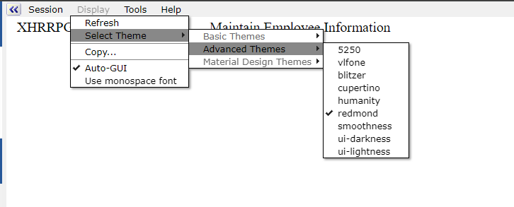

Using the jQuery Themes menu, you can change the default theme of the application.
The Shipped Basic jQuery Themes

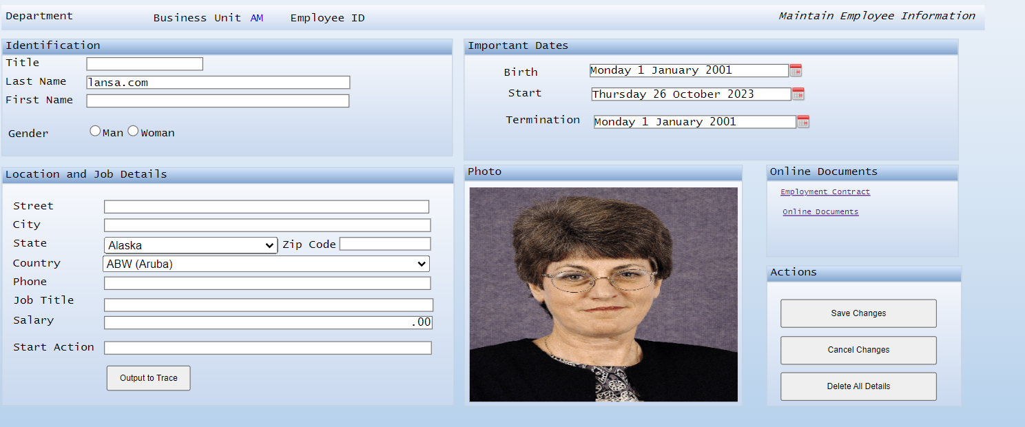

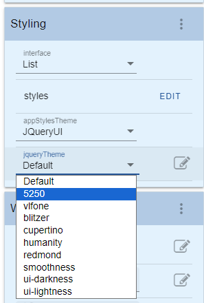

Turning jQuery Theme On

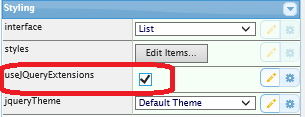

jQuery theme will be applied to existing or newly created projects by checking the Appication’s Styling->usejQueryExtensions checkbox.

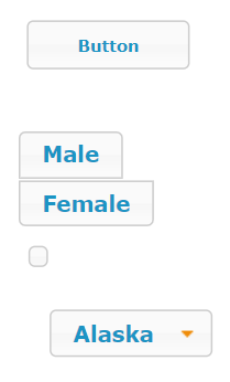

When a button, radio button, checkbox and dropdown exist in a screen, the default display will be as follows:
When usejQueryExtensions is checked, any extension currently added (buttons, dropdowns, etc.) which have no customized style will be set to the default jQuery theme, which is Redmond.
The appearance or style of the extensions will vary according to the currently chosen jQuery theme.
For more information of each extension’s change in appearance when using jQuery theme, please refer to the extension’s help documentation.
Changing jQuery Theme
To change the default theme to another theme, just choose any shipped themes from the Application’s jqueryTheme dropdown list. For example, choosing ui-lightness from the Application’s Styling->jqueryTheme dropdown list will change the display of the extensions shown above to the following:
After changing the theme using the jqueryTheme dropdown list, just save the project and unlock the screen. The display will automatically be changed to the selected jQuery theme.

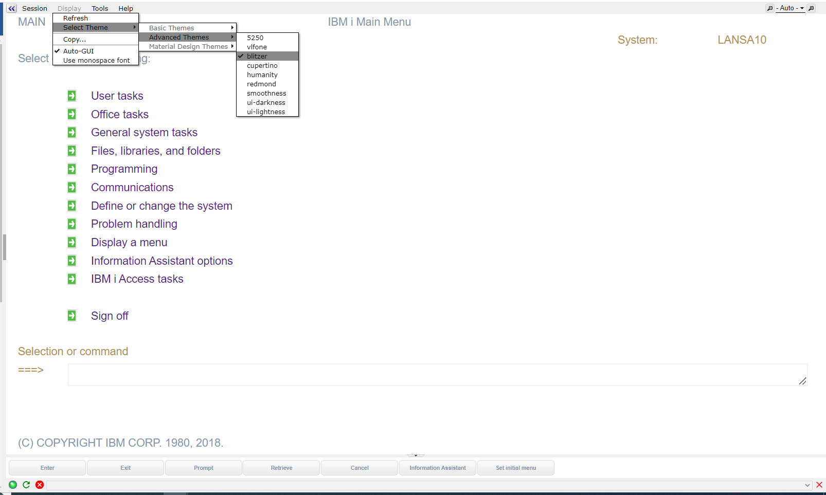

Dynamically Changing jQuery Theme

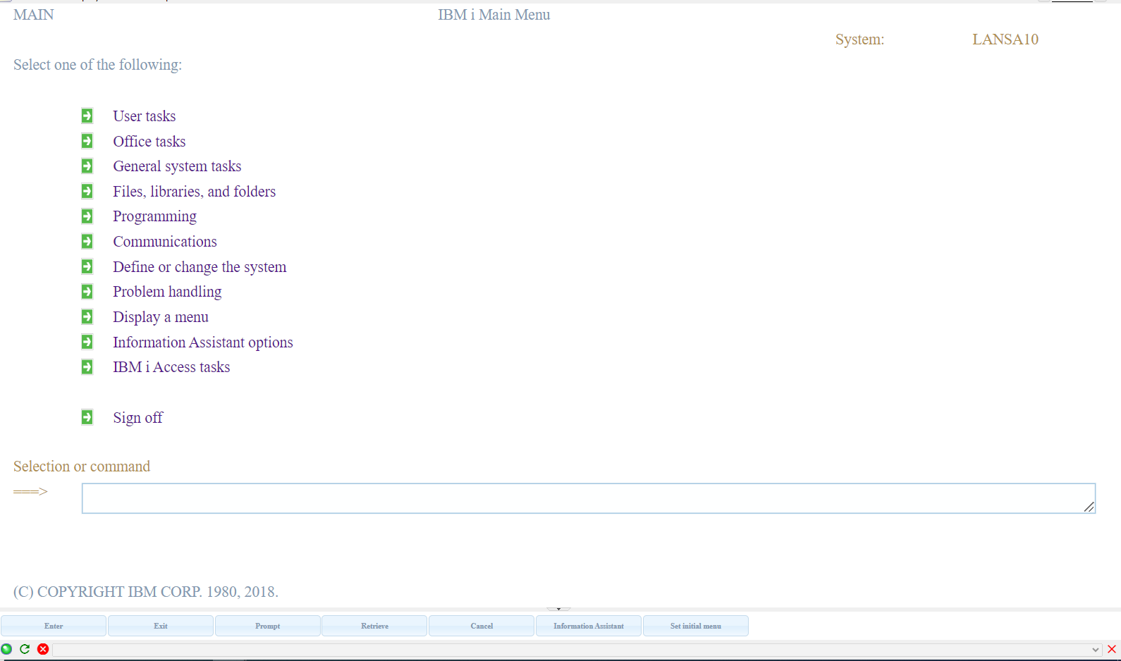

You can also dynamically change the jQuery theme by calling the SETAXESJQUERYTHEME() api. Calling GETAXESJQUERYTHEME() on the other hand will give you the current jQuery theme for the project.

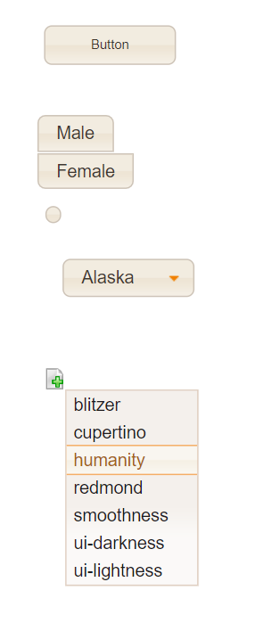

In this example a quick pick menu extension has been added to the System i Main Menu like this:
Notice how the display of the quick pick menu is in accordance with the currently selected jQuery theme.
The quick pick menu's onItemSelection property has this script:
var sTheme = "";
switch (ENV.itemNumber)
case 1: sTheme = "blitzer"; break;
case 2: sTheme = "cupertino"; break;
case 3: sTheme = "humanity"; break;
case 5: sTheme = "smoothness"; break;
case 6: sTheme = "ui-darkness"; break;
case 7: sTheme = "ui-lightness"; break;
default: sTheme = "redmond"; break;
SETAXESJQUERYTHEME(sTheme);
Using the above script, when “humanity” is selected from the quick pick menu, the screen extensions’ display will be changed to the following:
SETAXESJQUERYTHEME can be called on any property that allows scripting as an input.
Note: Calling SETAXESJQUERYTHEME will change the default jQuery theme for the application. This means that any screens that do not define its own jQuery theme using the jQuery Theme extension will be displayed using the jQuery theme that was set using SETAXESJQUERYTHEME.

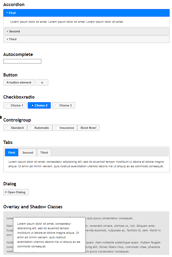

jQuery themes can be created or customized (change styles, rename, etc.) to suit your taste using the jQuery ThemeRoller web site at http://jqueryui.com/themeroller/. After customization, you can download and use the theme in your existing projects or on newly created ones. Below is the steps on how you can customize the jQuery theme to make the jQuery extensions appear as you want it to.

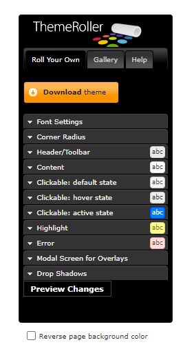

The ThemeRoller Interface
· Roll Your Own Tab
This tab is where you can create or customize the styles of your jQuery theme.
· Gallery Tab
The Gallery tab is where existing jQuery themes can be selected, downloaded and previewed. You can choose a theme by clicking at it and the preview will automatically be seen on the Preview portion of the page.
· Preview
On the right hand side of the page is where you can see the preview of the jQuery theme. When changing the values of certain styles using the Roll Your Tab, the preview part will automatically be updated to show your changes. In the Gallery Tab, when clicking on an existing theme, it will automatically be shown on the preview pane.
· Download Button
Download buttons exist both in the Roll Your Own tab and the Gallery Tab. Click the download button on the Gallery tab will take you to the download page where you can download the existing jQuery theme that you selected. Clicking the download button on the Roll Your Own tab will take you to the same download page but it will download the current settings or customization you have on the Roll Your Own tab.
Creating your own theme
To start creating your own theme, just go to the ThemeRoller page and change the settings on the Roll Your Own tab. The following are the styles that can be changed:
· Font Settings
Changing the font settings will affect the default font settings that is being used on all jQuery extensions. If no font settings is set for the application, this font setting will be used to display the text on the terminal screen.
Try to change the Font Size to 2.1em and see how most of the texts on the preview screen becomes large.
· Corner Radius
The corner radius is used for the rounding of the corners of the jQuery extensions. The lower the value, the smaller the rounding appears. As written in the “Note”, this setting is not supported on IE7 or IE8. Try changing the value to 1px and see on the preview how the round shape of the corners of the buttons, tabs, windows, etc. decrease.

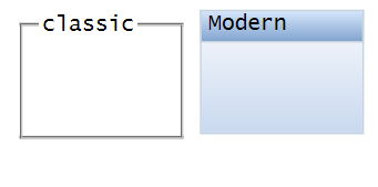

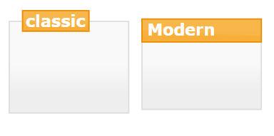

· Header/Toolbar
The Header/Toolbar setting is used in the jQuery Groupbox and Date extension. Changing these styles will impact the font, border, background and icons of the headers of the Group Box and the Date extension.
· Content
Changing the Content styles will change the background, border and text colour of the input boxes in the terminal screen. This includes the Inputbox, Multitype Input Box, jQuery Keypad, etc.
· Clickable: default state
These styles when changed will affect the text colour, background, icon and border of extensions that can be clicked such as Push Buttons, Mobile SMS, Date, etc. The default state indicates that this is the style of these clickable extensions when being displayed without any user interaction
· Clickable: hover state
These styles are applied to clickable extensions when the mouse is hovered over it. The style will revert back to the Clickable: default state once the mouse leaves the extension.
· Clickable: active state
The active state style will be applied when the clickable extensions are click or pushed. If the extension is a button, after pushing, the style will revert back to the default state. For other extensions that retains the push state, such as checkbox, radio buttons, etc., this style will remain unless the extension is clicked again. Clicking again will toggle the state back to the default state therefore applying the default state style.
· Highlight
This style is not currently being implemented in existing jQuery extensions. But it will be applied in future extensions where any message or information is displayed on the screen. This may include hints, placeholder, etc.
· Error
This style is also not yet being used in any extensions but can be used in future extensions where error messages needs to be displayed.
· Modal Screen for Overlays
This style is not yet being used but will be implemented on the background screen of a popup window.
· Drop Shadows
This style is not yet being used but will be implemented as a style for the popup window.

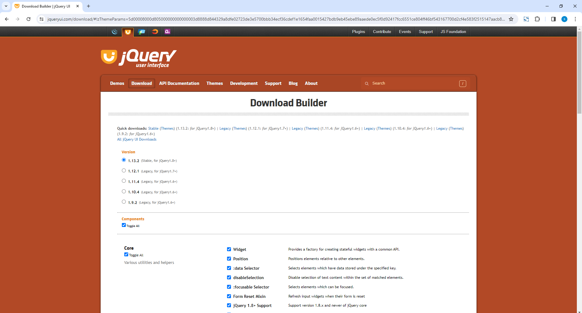

Downloading jQuery Themes
To download existing jQuery themes or customize existing themes to create your own theme, you can go the jQuery ThemeRoller web site at http://jqueryui.com/themeroller/.
To download customized theme, click on the Download theme button located on the Roll Your Own tab.
To download existing jQuery themes, click on the Download button located at the bottom of the theme you wish to download on the Gallery tab.
Clicking any of the download buttons mentioned above will bring you to the Theme Roller download page.
Just leave most of the settings unchanged and go to the bottom of the page.
Input “.terminalTheme” (with the dot) in the CSS Scope input box.
Click on the download button and save the files in your local folder.
Then extract the file (jquery-ui-1.11.4.custom.zip).
Rename the extracted folder to “jQtheme_” + <theme name> where <theme name> is the name of theme that you want to appear in the jqueryTheme dropdown list. The <theme name> is the name that will also be used to passed as an argument to the SETAXESJQUERYTHEME() api. So choose your name wisely.
After renaming, copy the whole directory (jQtheme_<theme name>) into your project’s theme folder located at \ts\screens\<project name>\projectThemes where <project name> is the name of your project where you wish to use the downloaded theme.
Note: Make sure to set the authorities of all the file inside the jQtheme_<theme name> ti *PUBLIC *R authorities. Use the WRKLNK command in your IBM i to ensure that the new files only have the *PUBLIC *R authorities.
If you want the theme to be selectable on newly created projects, just copy the theme folder into the \ts\ts2\css\projectThemes folder. Copying the theme into this folder will not make it selectable on existing projects. You need to copy the theme into the existing projects that you want it to be used.

Aside from being themeable, some of the noticeable difference between the basic and jQuery extensions are described below.

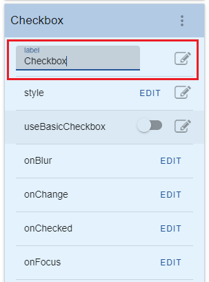

With the jQuery Checkbox extension, the label can be set using the label property of the extension. Setting the value of the label will automatically resize the button width so that the label will fit into the checkbox.
Label Property:

· Group Box
The only difference with the Basic and jQuery Group Box is that the jQuery Group Box extension will be displayed based on the jQuery theme set for the screen. When no theme is set but the usejQueryExtensions property is checked, the default Redmond theme will be used for the display.
Basic extension with Classic and Modern look:
jQuery Extension with Classic and Modern look (with default Redmond theme):
· Quick Pick Menu
There is no difference in the icon of the Quick Pick Menu but the display of the menu will be themed according to the currently set jQuery theme.
Basic Extension |
jQuery Extension |
· Radio Button
The jQuery Radio Button extension’s appearance and behaviour will be like the jQuery checkbox extension. The difference between the selected and unselected display can be seen below.
Basic extension |
jQuery Extension |

An example of display issues that may occur is as follows:
The Edit Employee Information screen customized without using jQuery Extensions
The same screen using the jQuery Extension
Since the base font for the two screens are different, the display issues indicated above will occur. Therefore, resizing and realigning the extensions on the screen will be needed.

jQuery Themes aXes Menu
When the Appication’s Styling->usejQueryExtensions checkbox is checked and the jqueryTheme property is set to “Default”, the jQuery Themes menu will be enabled. The menu is located in the aXes Display->Select Theme->jQuery Themes menu. All jQuery themes shipped with aXes will be listed in this menu.
When jQuery theme is enabled, after the user login then the themes can be selected.
Changing the theme is still possible using the menu which will result in the following screen when the theme is set to “blitzer” using the jQuery Themes menu.
When a Theme(jQuery) extension exist in a screen, changing the jQuery theme using the jQuery Themes menu will have no effect because the extension’s theme setting will have a higher priority. Therefore, the screen will always be displayed using the extension’s theme even if different themes are selected using the jQuery Themes menu.
