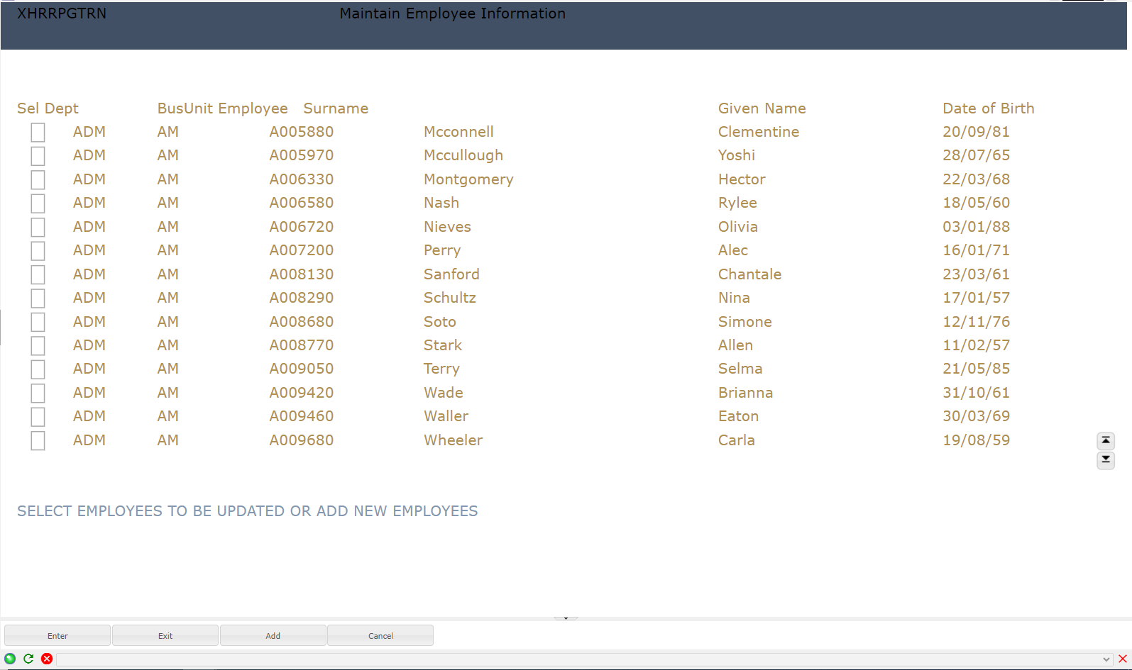

Sign on to a 5250 screen. |
Run the command ADDLIBLE AXESDEMO |
Run the command CALL XHRRPGTRN |
The resulting 5250 display should look like this:

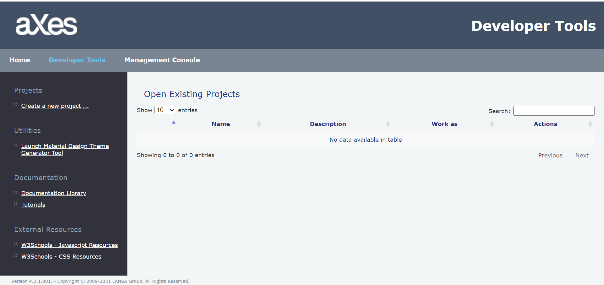

Use the new shortcut to open the aXes Home Page. Click on Developer Tools in the top bar.
When requested, enter the aXes developer user profile and password.
The shipped defaults are, User Name: dev Password: dev You should change these default values. Refer to the link below for more information Change the default password for developer tools projects |
The aXes Projects List should now be displayed, something like this:

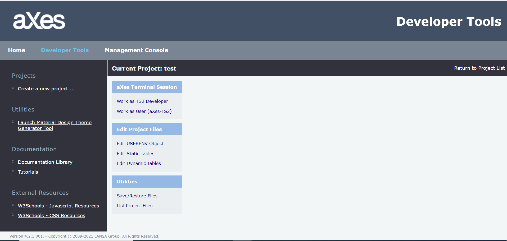

Then click the Create Project button.
A message like this should appear:
Close the Projects Home Page now.
