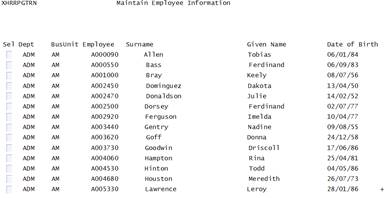

The resulting 5250 screen should look like this:

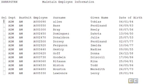

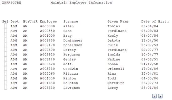

The modified screen should look like this:
