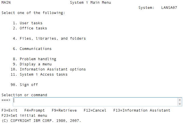

The IBM System i Main System Menu is uniquely identified With name MAIN and With the selection/ command entry input field named CommandLine:

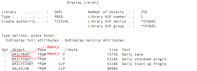

The IBM Display Library screen is uniquely identified with name DSPLIB and with the first two objects displayed named Object_1 and Object_2 respectively:
Note: Navigate to this screen using command DSPLIB QGPL (or any valid library name).

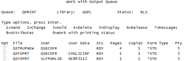

The IBM Work with Output Queue screen is uniquely identified with name WRKOUTQ:
Note: Navigate to this screen using WRKOUTQ QPRINT (or any valid output queue name).
