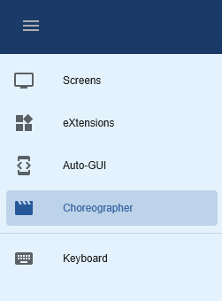

- Go the Choreographer tab.

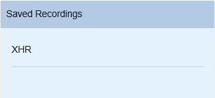

- The recording's name will be added into the Saved Recordings list.

- Click on the name of the recording you wish to play from the Saved Recordings list.
The recording's details will be displayed at the bottom.
